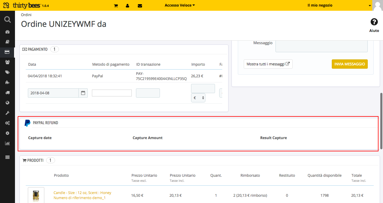

Beeta Posted April 6, 2018 Posted April 6, 2018 I'm testing 1.0.4 with PayPal 5.3.2 module (in sandbox mode). I cant understand how to issue a PayPal refund from the order page. What steps do I need to do to issue a refund on the order page? p.s. I'm able to do it with Stripe module but not with PayPal's one.

Beeta Posted April 7, 2018 Author Posted April 7, 2018 @slick_303 so the PayPal refund information on the order page are “read only” data pulled from PayPal? I’m going to try a manual refund from the sandbox and see if that row will show something.
Beeta Posted April 8, 2018 Author Posted April 8, 2018 @slick_303 I tried a manual refund but nothing came up in the dedicated Paypal refund box in the order detail... maybe is because I'm in sandbox mode? @mdekker @lesley can you give me some info about it?
SLiCK_303 Posted April 8, 2018 Posted April 8, 2018 When you do a manual refund in Paypal, it will NOT show up on your site. To my knowledge there is no way for you to sink up paypal with the site when it comes to a refund. Hopefully @mdekker can shed some more light on the subject....
hfxracing Posted April 9, 2018 Posted April 9, 2018 I think it's because your in sandbox mode. Your testing so its not a real transaction. I have used the button on the store to do a refund so I know it works. I prefer doing it directly at paypal since they show you all the fees reversed which you then can credit in your accounting.
Beeta Posted April 10, 2018 Author Posted April 10, 2018 Thank you for the info @hfxracing in "live mode" if I refund manually the refund will be visible on the order page too?
