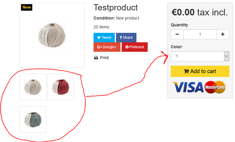

Hello, I am setting up a web shop that sells products that are available in various colors. These colors differ per product so I can't just use the attribute color picker. Additionally, the pattern on the product may differ depending on the color. So it's not just one color.
The dropdown menu would suffice, but not on its own, as the color attribute is expressed as a number and customers would have to go through each number to search for their color.
For that reason I would like the attribute to be picked by means of a list of images. So that each attribute option is a button containing the image (and possibly the number of the color as text). The default dropdown list should still remain for customers that do know their color number and can select it quickly without having to search through the whole list of images.
Here's an image of my current setup. So, what I basically want is additionally to the dropdown list for 'Color', the image thumbnails underneath the large image should act as a button and result in the 'Color' value being changed accordingly when selected. 0_1536172539412_eb507438-d787-4153-809d-77c144e56a1d-afbeelding.png

In this case it's JavaScript, though. A click on the picture should change the menu. As long as the menu is set correctly when the user clicks Add to cart, shop software will pick it up correctly. No additional PHP required.
If it's just three colors you might get away with per-color product images. Each combination can have a distinct cover image (tab Combinations on the product editing page) and changing the menu will change the main image to this cover image.

That's a pretty good solution. I was considering that, but figured I'd inform here first. Though I'm not sure if the HTML code of the thumbnail contains any reference to the attribute it's related to? (Haven't looked yet). And I've heard some people have browsers configured to block all JS. Not sure if the shop would even work in that case and I doubt it's not many but still something to consider.

Alright. But the other point, I found no reference in the HTML code to the attribute value. They're all added to the product as images, and then each image is shown regardless of if it is related to an attribute or not? Only when the attribute value is selected, the image changes. But I don't see any link or reference there that I could hook into to do that backwards (except for 'data-slide-num', if that number is correctly mapped to each attribute option..)

The way it works in my screenshot would be correct, I'd only need a way for the images to be a button to select that variant. As suggested above that can be Javascript, but perhaps there is another way that is easier :)
You have two choices, you can either add that link back, which is going to be hard, or you can hide the images underneath the main image and make the images in the color area bigger.
They are in both. Once in the value for the texture and then in the product so the product will switch to the image when you click on the color swatch.

Alright.. but that wouldn't work because there will be hundreds of products, each with dozens of colors. And each product has a unique color / texture. So I will end up with thousands of attribute - value pairs, while there can essentially be one color attribute with values 0 to 99 instead of a texture. Then that attribute can be applied to all products, and it will be on the product side to attach an image to it.
I guess I'll have to look at the code that switches the image depending on the value selected in the dropdown. Could you point me in the right direction for that?
