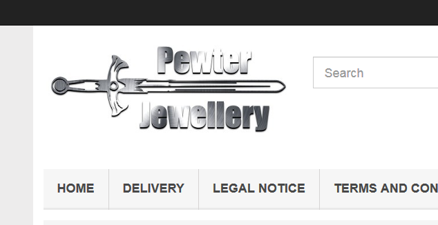

AndyC Posted October 22, 2018 Posted October 22, 2018 While editing and testing I have found my logo URL contains my name and have no idea how that got there.( if you right click and copy it gives the URL location) I have replaced the logo a few times but it only changes the ending and my name remains there. I've been through just about every setting searched google and can't find an answer to fix this issue.. I'm sure it is easy once I know how , so sorry if it is Thanks
colorful-ant Posted October 22, 2018 Posted October 22, 2018 @andyc im not sure what you mean. if i click on your logo - copy and save etc i do not know otherwise my result https://www.pewterjewellery.co.uk/img/andrew-clarke-logo-1540158876.jpg from your page
AndyC Posted October 23, 2018 Author Posted October 23, 2018 Yep , but why does it have my name in the link the dash logo is the only part that changes

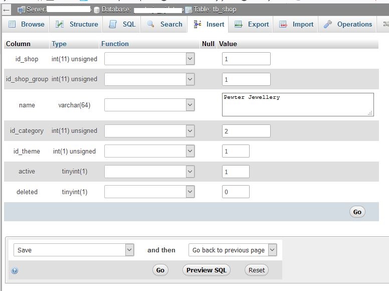

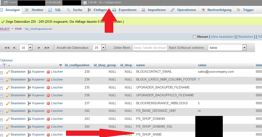

LeeBrys Posted October 23, 2018 Posted October 23, 2018 I also found your name in one of the javascripts as the store name. I was able to reproduce exactly what you are seeing in a test store. I verified that changing the store name under shop contacts updates the PSSHOPNAME in the tbconfiguration database table. So I searched the database for the old name and found it in tbshop. After changing it there and uploading a new logo the file name shows correct. Can you take a look at tb_shop and see if that solves the problem?
AndyC Posted October 23, 2018 Author Posted October 23, 2018 First time I've gone there. Found it and it says Pewter Jewellery, or am I looking in the wrong place Thanks

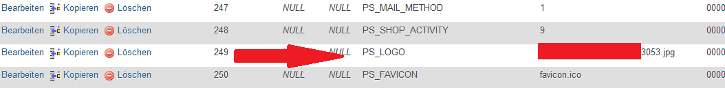

colorful-ant Posted October 23, 2018 Posted October 23, 2018 or try this (same table) and dont forget to change the file with jpg-name in your folder
AndyC Posted October 23, 2018 Author Posted October 23, 2018 Found them. I see there was more than 1 page which is why I missed the right place. But Shop name is Pewter Jewellery PSLogo is logo.jpg Was so hoping it would be simple Out of pure curiosity, the first few pages in the root of the database have (for example) tb1access etc .. Is the 1 suppose to be there
