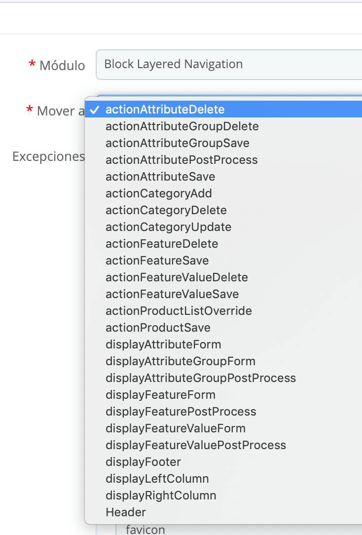

danwarrior Posted January 8, 2019 Share Posted January 8, 2019 Hi, guys! I want to move the Faceted search module to the main column but positions are limited when I try to configure the new position. Do you know wich change I need to do (I think is via code) to insert in the main center column or another hook of my theme? Thank you very much! Link to comment Share on other sites More sharing options...

0 danwarrior Posted January 10, 2019 Author Share Posted January 10, 2019 @lesley Thanks, Lesley! I've done it but there is not showing yet from Module Positions: Maybe I need to change something more? Link to comment Share on other sites More sharing options...

0 danwarrior Posted January 10, 2019 Author Share Posted January 10, 2019 @lesley I can't, the hook is not on the list... Link to comment Share on other sites More sharing options...
0 lesley Posted January 10, 2019 Share Posted January 10, 2019 On the transplant list? Or the list of hooks on the positions page? Link to comment Share on other sites More sharing options...
0 danwarrior Posted January 10, 2019 Author Share Posted January 10, 2019 @lesley I'm not sure if I'm understanding what you mean... I've already show the screenshot: I've add that code, upload to the FTP and then, when I try to add the module to the new hook (from "positions" menu option), Display TopColumn is not showing. Is there any step more? Link to comment Share on other sites More sharing options...

0 danwarrior Posted January 10, 2019 Author Share Posted January 10, 2019 @lesley Mmm, that's what I'm doing. I've reseted too but nothing: https://elplandedan.com/wp-content/uploads/2019/01/Screenshot-2019-01-10-at-22.30.02.png Link to comment Share on other sites More sharing options...

0 danwarrior Posted January 10, 2019 Author Share Posted January 10, 2019 @lesley It only shows that "Display TopColumn" isn't in the list of transplant module (after I've added that code) :) Link to comment Share on other sites More sharing options...
