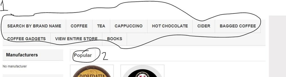

CoffeeGuy 4 Posted January 19 See attached... I used to have New Arrivals, Best Sellers, and Popular here (where I have it indicated with a 2) but I decided to remove ALL (I can't find how to remove POPULAR) and start off with all products in my store, so basically 'no tab' or just show the start of my products. Is there a way to do that? Share this post Link to post Share on other sites

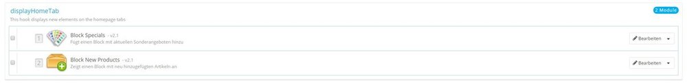

wakabayashi 264 Posted January 19 Maybe it works to remove the module from the "displayHomeTab" hook. (I haven't tested) Share this post Link to post Share on other sites
CoffeeGuy 4 Posted January 19 Under themes? There's nothing under "hook home" Share this post Link to post Share on other sites
wakabayashi 264 Posted January 19 Under Modules -> Positions Share this post Link to post Share on other sites
CoffeeGuy 4 Posted January 19 There isn't a 'popular' tab listed anywhere at that location. 😞 Share this post Link to post Share on other sites
wakabayashi 264 Posted January 19 What modules do you have in there? Share this post Link to post Share on other sites
CoffeeGuy 4 Posted January 19 Alphabetical order, so I can't post the whole thing... Too many, but POPULAR isn't here... Share this post Link to post Share on other sites
CoffeeGuy 4 Posted January 19 IDEALLY I'd like to replace "Popular" with "View Entire Store" or "All Products" Share this post Link to post Share on other sites
datakick 572 Posted January 19 Disable module Block Featured Products Share this post Link to post Share on other sites
wakabayashi 264 Posted January 19 you are not at the right place... Share this post Link to post Share on other sites
wakabayashi 264 Posted January 19 2 minutes ago, datakick said: Disable module Block Featured Products I thought he still wants to use it and just take the title away... But ok his mind anyway changed 🙂 @CoffeeGuy To change the name you should go under. Translations and change it... Share this post Link to post Share on other sites
CoffeeGuy 4 Posted January 19 Thanks guys. The "Popular" tab is now gone, but again, ideally, I'd like to show all my products as soon as they go to my page. Where the POPULAR tab used to be. Share this post Link to post Share on other sites
CoffeeGuy 4 Posted January 19 I'd like it to be like this:https://bryankollar.com/coffeeguy/view-entire-store As soon as they reach the site instead of clicking on 'view entire store' Maybe I can use a redirect... hm... Any other way? Share this post Link to post Share on other sites
wakabayashi 264 Posted January 19 IMHO this isn't a good solution in your case. To show (and load!) all products on homepage only makes sense if you have like only 20 products. In your case I would stay with the popular and add a big button below: "See all our products". The link goes to the category you showed... 1 Share this post Link to post Share on other sites
CoffeeGuy 4 Posted January 19 (edited) That WOULD be ideal!!! OK, so last question is how do I add a big button? Is it a tab? Edited January 19 by CoffeeGuy Share this post Link to post Share on other sites
