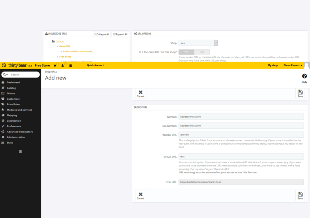

When I add a shop to multistore I get a 404 just for the second store not my main store. I did this
with PS and worked at first but to many bugs, So I don't think I am doing it wrong.
I have my Performance set to force compilation, cache set to no. I tried with friendly url's no and off
I checked the debug mode and no errors. Any help would be appreciated.
                               Thanks Glenn

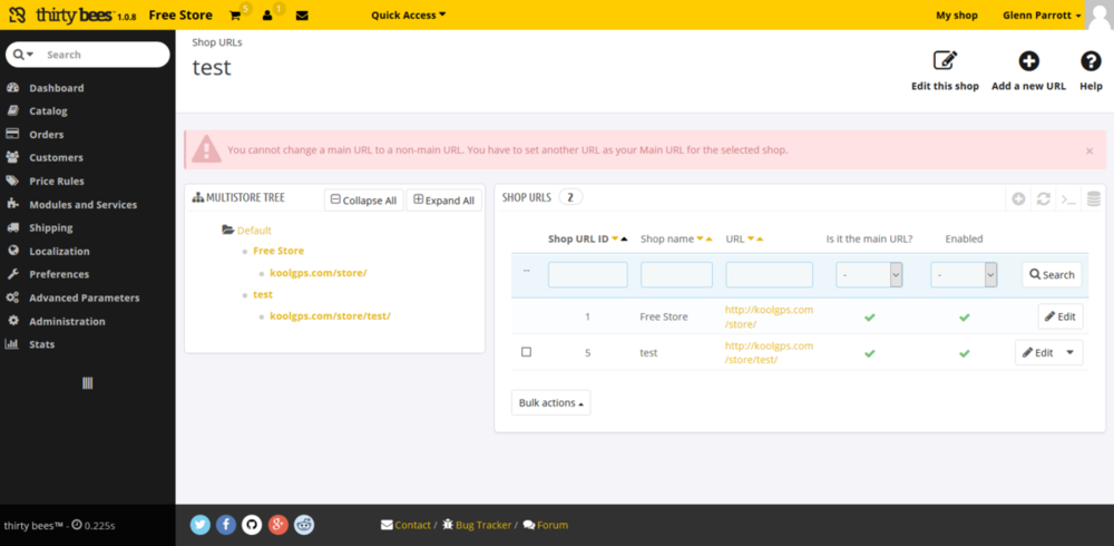

I think I found my problem, when I add a store in multistore it makes it a main URL. I know I can only have
1 main URL, but it wont let me change it or add it so it is not the main URL.
Edited by gelnn
The configuration is correct. It has to be 2 main urls. Have you tried to work with a subdomain instead of virtual shop? I have a similair issue in my testshop...
Edit: It's interesting that I can make it work with multiple domains/subdomains. But not with virtual directories. Do you know something about your server configuration? Do you use Nginx?
