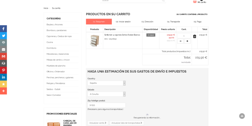

jmeca Posted September 23, 2019 Author Share Posted September 23, 2019 16 hours ago, Factor said: More info needed. What carriers do you have set up? Do you get shipping data like prices in checkout? I can find a lot of data on how it is used. Did you use it in the old ps 1.6? I looked here on GitHub I don't see any issues logged against the module. https://github.com/thirtybees/carriercompare even the old PS module has on one issue. https://github.com/PrestaShop/carriercompare/ Hi. Thanks for your help. If I have the transporters already created. I have downloaded it from here https://github.com/thirtybees/carriercompare In the shopping cart do not appear shipping costs as shown in the image Link to comment Share on other sites More sharing options...

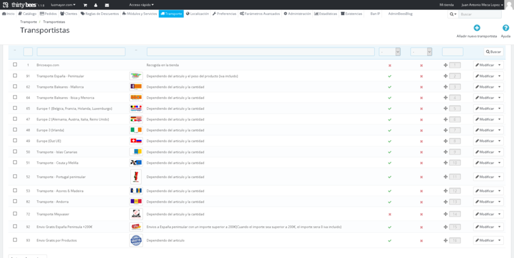

Factor Posted September 23, 2019 Share Posted September 23, 2019 (edited) You have all the ranges setup? In the carrier section? You also put in a address and post code in checkout? Edited September 23, 2019 by Factor Link to comment Share on other sites More sharing options...

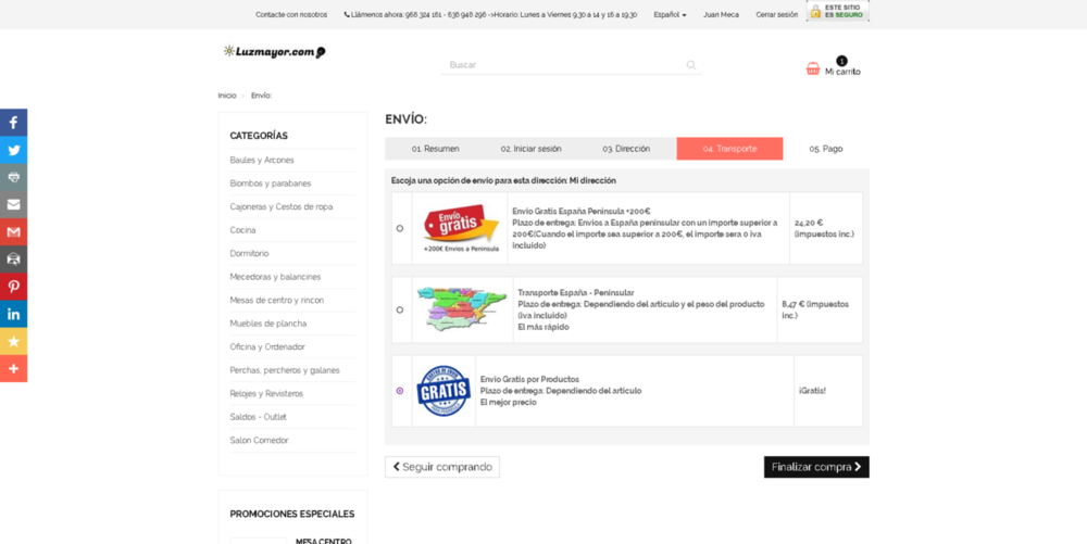

dynambee Posted September 24, 2019 Share Posted September 24, 2019 14 hours ago, jmeca said: In the shopping cart do not appear shipping costs as shown in the image What happens further through the checkout process, on step #4 where carriers are usually chosen? Do all the different carriers show up there properly? Can you post a screenshot of that? Link to comment Share on other sites More sharing options...
jmeca Posted September 24, 2019 Author Share Posted September 24, 2019 7 hours ago, Factor said: You have all the ranges setup? In the carrier section? You also put in a address and post code in checkout? Yes of course Link to comment Share on other sites More sharing options...
jmeca Posted September 24, 2019 Author Share Posted September 24, 2019 9 hours ago, dynambee said: What happens further through the checkout process, on step #4 where carriers are usually chosen? Do all the different carriers show up there properly? Can you post a screenshot of that? I think it's ok Link to comment Share on other sites More sharing options...
dynambee Posted September 24, 2019 Share Posted September 24, 2019 1 hour ago, jmeca said: I think it's ok Looks like the carriers themselves are set up then so for some reason the module isn't working correctly. The next step is what @lesley said, enable error reporting so it is possible to see what is causing the module to fail. Link to comment Share on other sites More sharing options...

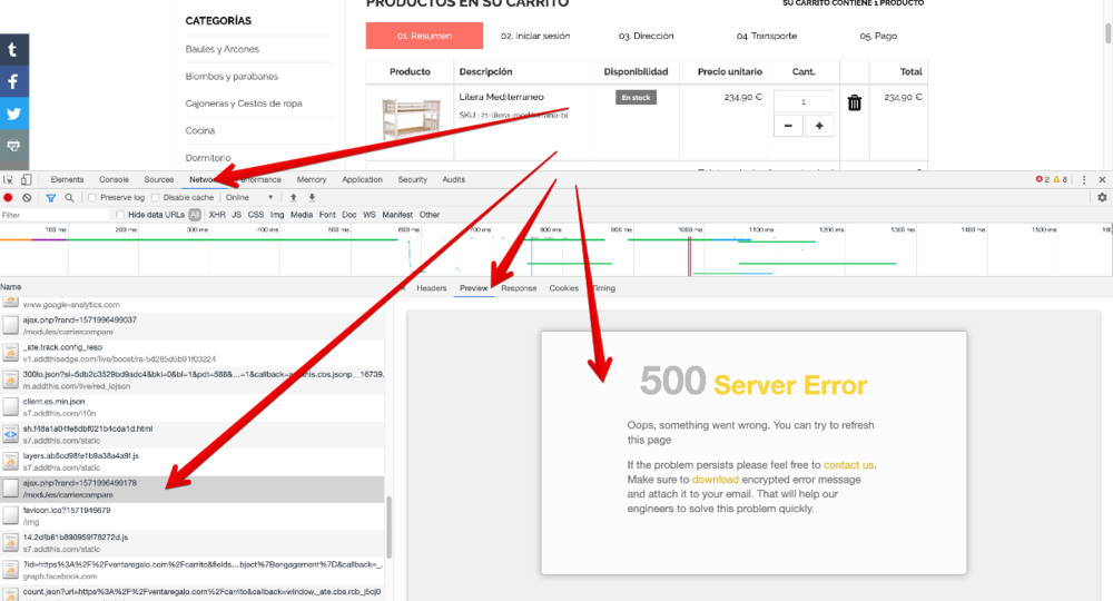

datakick Posted October 25, 2019 Share Posted October 25, 2019 You can do this: enable debug mode open javascript console click to Networks tab Find 500 post request and click on it click on Preview tell us what the page says Link to comment Share on other sites More sharing options...
jmeca Posted October 25, 2019 Author Share Posted October 25, 2019 Only white screen can i see Link to comment Share on other sites More sharing options...
datakick Posted October 25, 2019 Share Posted October 25, 2019 Strange, I can see the error code clearly: Anyway, the problem is this: The module tries to create temp/dummy address in order to calculate shipping cost to that address. Because ajax request didn't provided any zipcode: module ends up trying to create address with empty postcode, resulting in this error code. The best way to fix this is to modify php code and properly handle the situation when no postcode is provided. Alternatively, you can modify javascript code and pass some dummy zipcode, when none was entered yet. Link to comment Share on other sites More sharing options...
