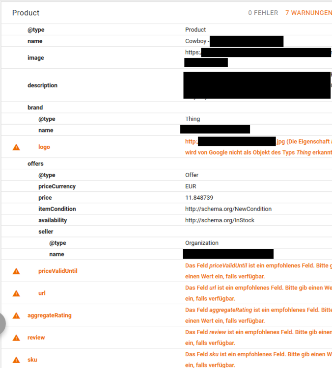

In the ld + json module, I have some clues in my tests that lack data.

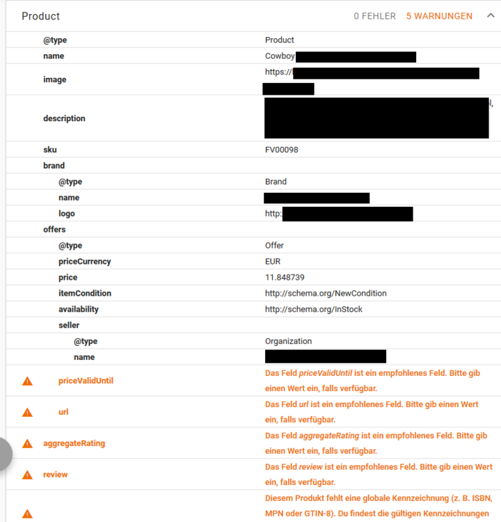

Currently I have made the following changes for me:
jsonmodule.php
Article number (sku)
lines old
            if (!empty($product->upc)) {
                $arrProduct['sku'] = $product->upc;
lines new
            if (!empty($product->reference)) {
                $arrProduct['sku'] = $product->reference;
thanks @dosbiner @lesley
your changed files image brand logo is great
https://github.com/thirtybees/jsonmodule/commit/9b877fbff8be726c50f7abcdd7684b9f56ab0176

test before
test after

I do not know what to describe in more detail? I think my sentences in the first comment are sufficient. Also deposited with pictures. There you can see where more warnings are in the review of the structured data.
