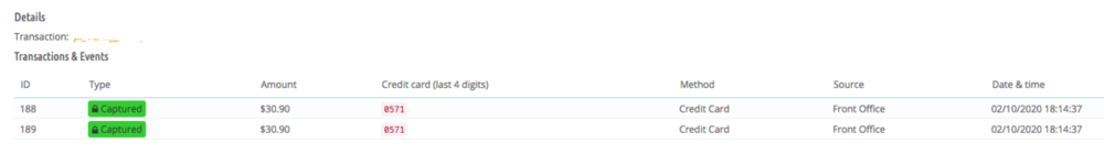

Received a duplicate order but only only actually processed with stripe
They both have two different order numbers, ID numbers, are listed TWICE in order history.
They are counted TWICE for sales in the BO even though only ONE was processed through stripe.
516437956_ScreenShot2020-02-12at5_35_45PM.thumb.png.32b37d55a4c8c2ba7ee0c8105fe60320.png
It looks like the orders were seconds apart.

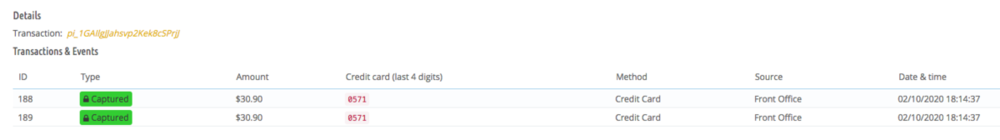

Both reference the SAME stripe transaction ID but the order amount was only processed ONCE through stripe
1508443010_ScreenShot2020-02-12at5_35_08PM.thumb.png.ad3f7de9ac5ed13e0bfc19bec7267def.png

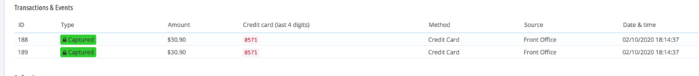

BO shows stripe: Credit Card one with a lock the other without as show in this image.
The one with the lock is the one that actually processed even though both are counted for sales.

The duplicate does not charge STRIPE twice but customer history shows as spent and inventory is deducted as shown in my screen caps in first post.
