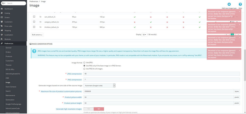

I am regenerating new images in Webp, but i get the following error after 1810 pictures and the process stops.
"Received a 5xx response (generic error). Make the rate limit of the server has been (temporarily) increased"
The error keeps popping up but after few hours still just 181 pictures. Probably a big picture. How to find out which picture or how te set the server better?

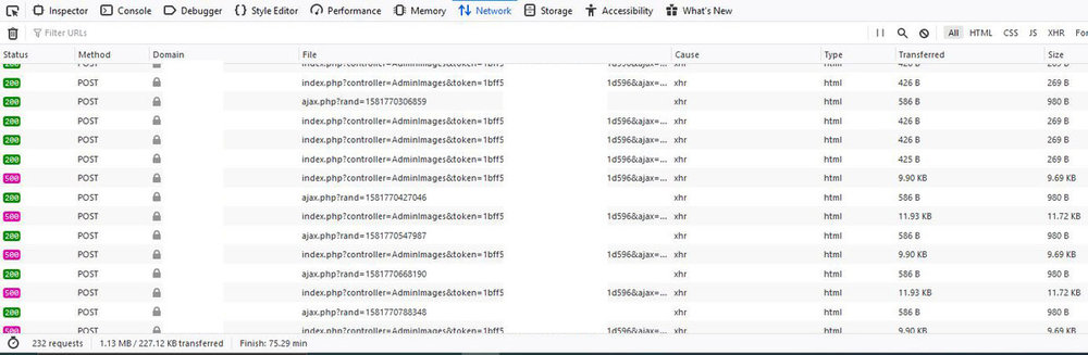

How the error looks attached.
Your server throws some 5xx error, and we can't help you unless we know what it is. You can look into browser javascript console, in Network tab, and look for these 500 error responses. They should contain some more information

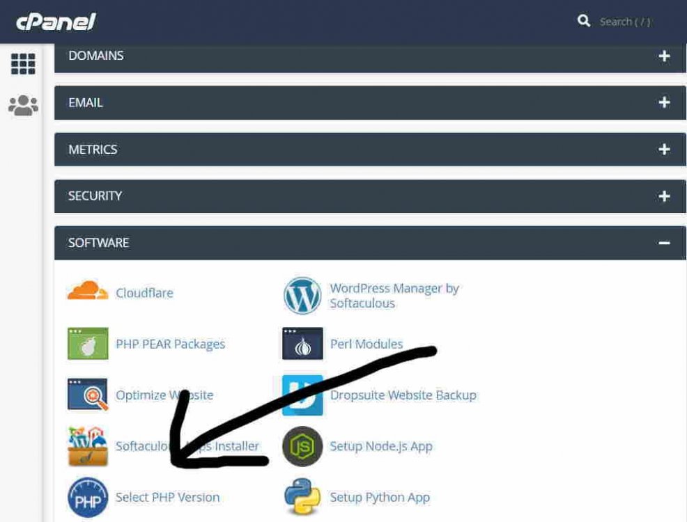

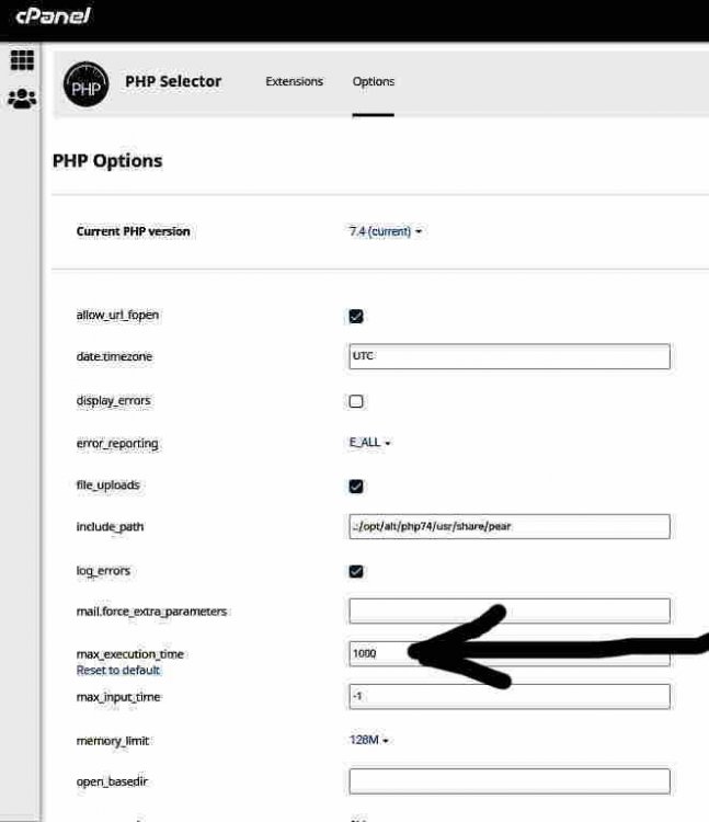

Just for information, if anyone is looking for the same thing for example on Hosting.co.uk's cheapest server.
It used to show Error 5.xx messages as above.
Cpanel > SelectPHP > Options > Max Execution Time > 1000
then maybe reset to default if I remember.

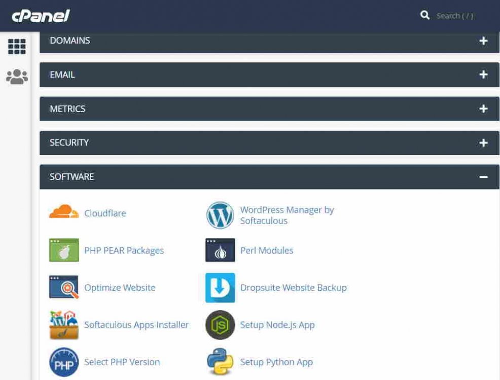

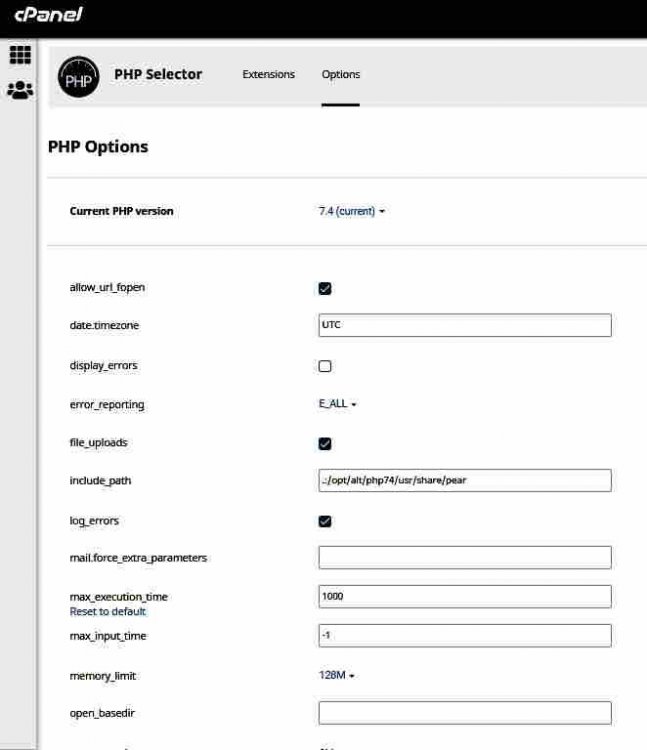

PS
I don't know how to delete the first two screenshots here.
The second two are the same with arrows.
Edited by veganline
tried removing first two screen shots but am not sure how
