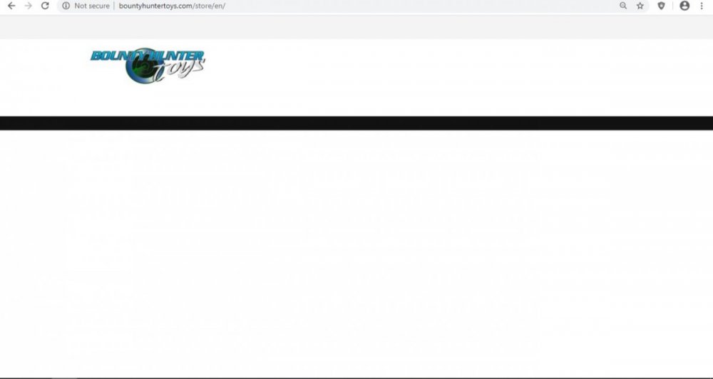

bhtoys Posted May 17, 2020 Posted May 17, 2020 As you can see in the image. This is what my site looks like after coming out of maintenance mode. I changed themes, same thing. I've not made any changes to the layout of the site, other than mess around with the taxes.

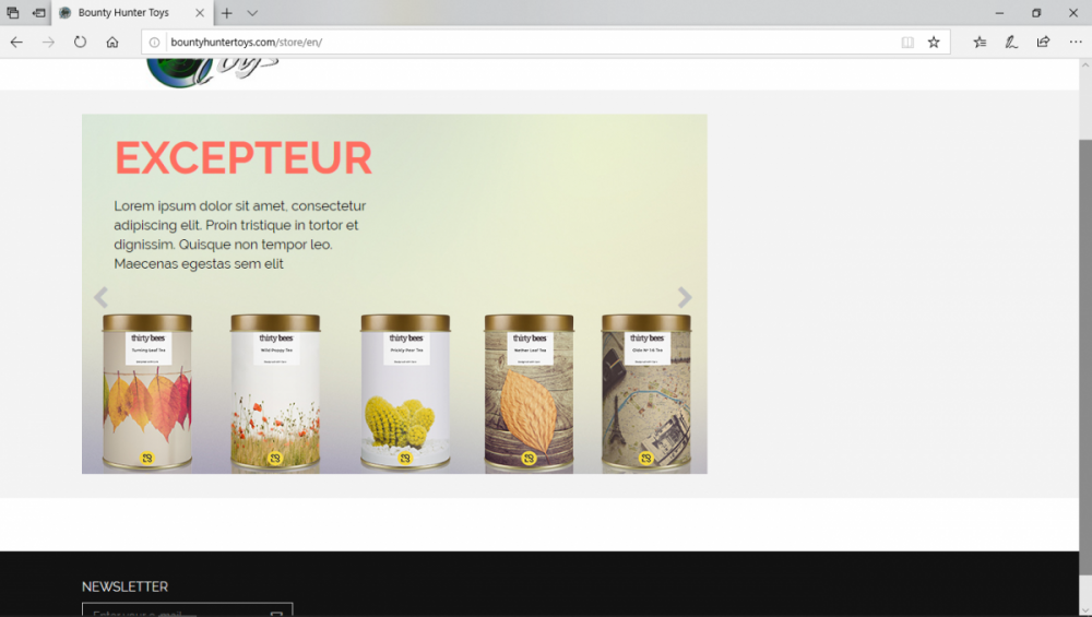

0 bhtoys Posted May 17, 2020 Author Posted May 17, 2020 After changing themes... I now get this... my store logo is shown in full - but I moved it to show the bottom as well.
0 the.rampage.rado Posted May 17, 2020 Posted May 17, 2020 If you change themes few more times it can get even 'prettier'... First of all - what you changed before maintanence? Surely it can't be just taxes. Second - after changing themes they do some minor adjustments that we don't need when debugging this issue - do you have recen backup you can revert to? If not does your host make daily incremental backups that you can use?

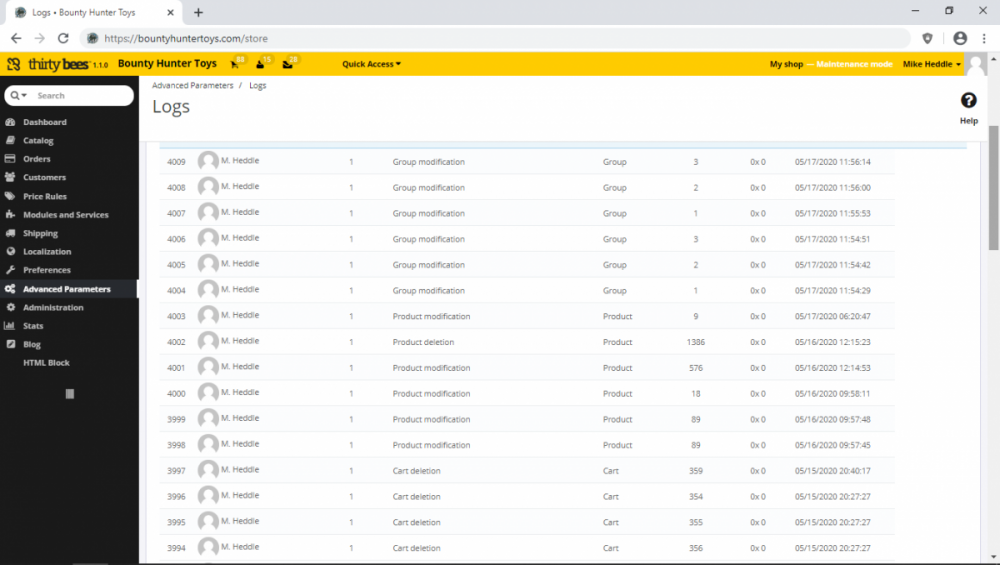

0 bhtoys Posted May 17, 2020 Author Posted May 17, 2020 (edited) On 5/17/2020 at 4:45 PM, the.rampage.rado said: If you change themes few more times it can get even 'prettier'... Expand I only changed it once, AFTER that black bar appeared. On 5/17/2020 at 4:45 PM, the.rampage.rado said: First of all - what you changed before maintanence? Surely it can't be just taxes. Expand Taxes were yesterday, and the site worked after that. Today I was checking Group Modifications. That wouldn't do it either. Here's the logs screen. On 5/17/2020 at 4:45 PM, the.rampage.rado said: Second - after changing themes they do some minor adjustments that we don't need when debugging this issue - do you have recen backup you can revert to? If not does your host make daily incremental backups that you can use? Expand Like I said, I changed the theme AFTER the black bar showed up. If I had a recent backup, I would of tried it. But I don't. I'll also say, everything in the admin is still there. products, sales, everything. Edited May 17, 2020 by bhtoys
