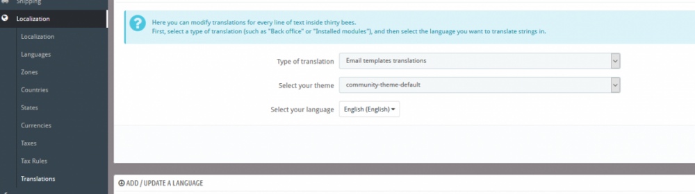

Owen Posted July 18, 2020 Posted July 18, 2020 Does anyone know how to change the email template contents and then translate them into another language?
0 colorful-ant Posted July 18, 2020 Posted July 18, 2020 (edited) sorry - it is not meant bad overall. I wish some would search more here in the forum beforehand - or in the prestashop forum.you can change the translation here. translation email -> localization -> translations If you want to change mail templates, there are many helpful tips - as mentioned above in one of the two forums.Unfortunately you have not given any exact information about what and where in which mail template should be changed! So nobody can help further! ! ! ! ! Edited July 18, 2020 by colorful-ant
0 Owen Posted July 19, 2020 Author Posted July 19, 2020 8 hours ago, colorful-ant said: sorry - it is not meant bad overall. I wish some would search more here in the forum beforehand - or in the prestashop forum.you can change the translation here. translation email -> localization -> translations If you want to change mail templates, there are many helpful tips - as mentioned above in one of the two forums.Unfortunately you have not given any exact information about what and where in which mail template should be changed! So nobody can help further! ! ! ! ! Hi Color-ant, I had tried the way you introduced localization-translation before, but failed and it indicates below: Forbidden You don't have permission to access /bao/login/index.php on this server. Do you know why? Thank you~

0 Wartin Posted July 19, 2020 Posted July 19, 2020 6 hours ago, Owen said: Forbidden You don't have permission to access /bao/login/index.php on this server. Hello, I had that same issue. Check mod security in cPanel if it's a shared hosting. https://forum.thirtybees.com/topic/4115-403-forbidden-when-translating-email-templates/?do=findComment&comment=36270
0 DRMasterChief Posted July 19, 2020 Posted July 19, 2020 It is much more recommended to edit the email templates locally and then upload/overwrite the original ones. Editing online oftens does not work for email templates. You can find a lot of help with this online and in the forum. https://html5-editor.net/ is a good editor, you can load your html from email template in this and change it to your needs, then copy the html code and safe it, then upload it to the correct folder in tb installation.
