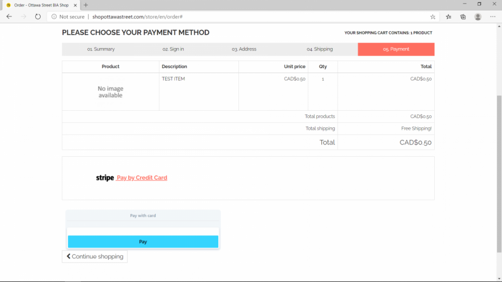

bhtoys Posted August 17, 2020 Posted August 17, 2020 (edited) So here's the deal. I've got the test keys working perfectly. Did a couple of test orders via them. When I activate it to go live, I can't pay for anything. The option to enter a CC # is missing. When I click on the space above that (Stripe : Pay by Credit Card), it just pops me back up to the top of that page. When I click on the section where you're supposed to enter your CC#, (Pay with card) it takes me back to the address page. I've been struggling with this for two weeks. It's for a not for profit BIA, with the money raised from these items going to Food4Kids, and the site is slated to go live in a few days. I've never run into an issue like this before where the test version works, but the live version doesn't. Any suggestions? Edited August 17, 2020 by bhtoys

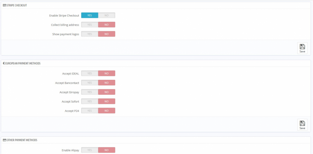

x97wehner Posted August 17, 2020 Posted August 17, 2020 I have it running with no issue is both test and live setting. I set it up according to documentation on the module. I found the embedded form that you show at the bottom to be non-user friendly so these settings pop them to the stripe payment page when they click the link, similar to how PayPal works, if you are familiar. Here are my settings that are working: 1
bhtoys Posted August 17, 2020 Author Posted August 17, 2020 On 5/26/2020 at 5:31 PM, datakick said: 4 minutes ago, x97wehner said: I have it running with no issue is both test and live setting. I set it up according to documentation on the module. I found the embedded form that you show at the bottom to be non-user friendly so these settings pop them to the stripe payment page when they click the link, similar to how PayPal works, if you are familiar. Here are my settings that are working: Thanks! Set mine up the same as yours just now - still get the "pop" to the top of that page. Extremely frustrating. Especially with a deadline. 1
x97wehner Posted August 17, 2020 Posted August 17, 2020 Other than that, all I can advise is making sure to clear all cache in both you store, as well as your browser (Or just use another browser) to ensure that is not the issue.
bhtoys Posted August 17, 2020 Author Posted August 17, 2020 (edited) 4 minutes ago, x97wehner said: Other than that, all I can advise is making sure to clear all cache in both you store, as well as your browser (Or just use another browser) to ensure that is not the issue. Tried three browsers, and my phone. One of them should of worked by now. Appreciate the help. Anyone else have any suggestions? Edited August 17, 2020 by bhtoys
datakick Posted August 17, 2020 Posted August 17, 2020 If you look into your javascript console, you will find the reason: Live Stripe.js integrations must use HTTPS. For more information: https://stripe.com/docs/security#tls You have to Enable SSL , and you should also set automatic redirect from http to https version. Read here for more info
datakick Posted August 18, 2020 Posted August 18, 2020 15 hours ago, bhtoys said: that did it! Thanks! Glad I could help. Let's add some check and big warning into the module's back office page, so this won't happen to other users 3
