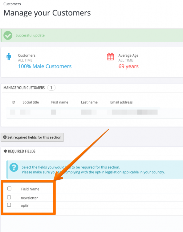

datakick Posted September 23, 2020 Posted September 23, 2020 All right, the problem was in *Required fields* settings for Customer record. If you check these fields, your system won't allow you so save customer entry into the database without Opt/Newsletter. 1 1
Russ Posted September 23, 2020 Author Posted September 23, 2020 (edited) Well - I never even saw those settings before Petr - I promise! I hope somebody else benefits! - 😎 Edited September 23, 2020 by Russ
