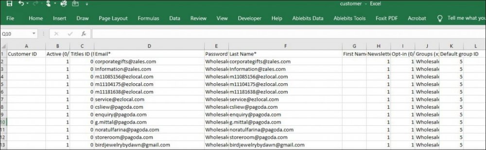

RonGin Posted September 30, 2020 Posted September 30, 2020 Hi, I am trying to add in 1968 names into my wholesale category. When I upload it goes and then when I look there is no customers. I am add my header I have in the cvs upload sheet below labels my edit. then I am adding the one I received from thirty bees. My customer list has no names so for the last name I put company store and took off the * for required in first name. Other than that I changed nothing. I would like to upload this asap so please try and respond with help very soon.

RonGin Posted October 1, 2020 Author Posted October 1, 2020 (edited) I just tried again this is the errors its seems that the program is looking for some sort of sequence in the first and last name. I don't use them how can I over-ride this to import what I put into the blocks? Edited October 1, 2020 by RonGin add to text
haylau Posted October 1, 2020 Posted October 1, 2020 That is saying last name is empty, It can’t be empty as it is a required field Would be easier for us to see some actual data that you are importing. So we can see what is in the cells
musicmaster Posted October 1, 2020 Posted October 1, 2020 Lastname is required. So you might make it the same as the email address.
RonGin Posted October 1, 2020 Author Posted October 1, 2020 59 minutes ago, musicmaster said: Lastname is required. So you might make it the same as the email address. I have changed that and last name error still appears I have attached a new copy of excel 9 hours ago, haylau said: That is saying last name is empty, It can’t be empty as it is a required field Would be easier for us to see some actual data that you are importing. So we can see what is in the cells
haylau Posted October 1, 2020 Posted October 1, 2020 First Name is a required field, it can’t be blank. Not sure you can have special characters in the last name either
Wartin Posted October 2, 2020 Posted October 2, 2020 8 hours ago, RonGin said: I have changed that and last name error still appears I have attached a new copy of excel As Haylau said, maybe the problem is that '@'. Try filling the column with what is before the '@'. Or just with 'Doe', just to try. Always make backup of your databases :)
RonGin Posted October 2, 2020 Author Posted October 2, 2020 1 hour ago, Wartin said: As Haylau said, maybe the problem is that '@'. Try filling the column with what is before the '@'. Or just with 'Doe', just to try. Always make backup of your databases :) Hi I have tried changing the names with john doe , buyer, I still get the message that the name field is empty. Is there a way to clear the cache in thirty bees, might be pickup up residue tries.
musicmaster Posted October 2, 2020 Posted October 2, 2020 Can you try importing the example csv file. And then step-by-step changing it to your format.
Wartin Posted October 2, 2020 Posted October 2, 2020 9 hours ago, RonGin said: Hi I have tried changing the names with john doe , buyer, I still get the message that the name field is empty. Is there a way to clear the cache in thirty bees, might be pickup up residue tries. But in the excel screenshot the name is empty. Yes, sometimes you need to clear the cache. It is in Advanced parameters -> Performance. (there is a search bar in the top-left, if you cannot find it search for 'cache').
