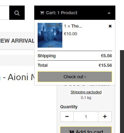

RabbitZzZ Posted January 8, 2021 Author Posted January 8, 2021 This is how it looks, when I add the first product. When I have switched to another page afterwards. added a second product And on the checkout page.
RabbitZzZ Posted January 14, 2021 Author Posted January 14, 2021 So it seems like core updater didn't update the community-default theme completely. I checked the modules/blockcart folder against the version from git and they were different. I now updated it manually but the problem ist not 100% solved. Still the latest added product in the cart has the bigger image size upon adding. The only "improvement" is that on checkout only the last product is shown double in the flyout cart and not all products as before.
