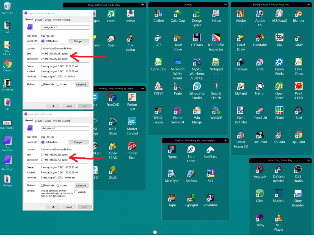

Billy Posted August 7, 2021 Author Posted August 7, 2021 So I'm back too hopefully understand why the .sql backups I download are different sizes. So in this first snap above I have my live site in maintenance mode. I have cleaned all the tables with "Database Optimization" module. In this second snap I download my website .sql file while the website is closed and tables are clean. In this third snap I'm logged in as root in Web Host Manager (WHM) and I download my website .sql file again to compare with the first one from cPanel. In this finial snap I am comparing the size of each .sql file and as you can see they are different. This is what I don't understand. Why are they different sizes? brb with another post to finish up all the info I have gathered this morning. Again I'm just trying to understand why. Ty Billy
Billy Posted August 7, 2021 Author Posted August 7, 2021 (edited) This is my finial point and now I'm really confused about all this. lol So I went ahead a created two new databases on my Windows 10 desktop computer. I am running Wamp Server with MySql 5.7.31 with phpMyAdmin 4.9.7. So now that I have uploaded both of those .sql files to my local host via "MySQL Console" and have both perfect databases with different sizes files in them. I turn around and download them again from my local host this time and now look at the files sizes??? This is the kind of stuff that drives me crazy. Look I guess it doesn't matter to anyone but me. However if you were to do the same experiment your results would be the same as mine. I just wish I understood my results better... ---- Okay time to move on to my other threads here. I'm still trying to get to my finial thread on the copy_shopdata module post that I haven't made yet. Let me finish my "theme thread" and the "database diff thread" first tho. _Best Billy Edited August 7, 2021 by Script-Fu
