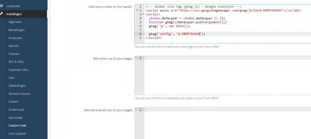

0 Willem Posted May 24, 2022 Share Posted May 24, 2022 ok, i don't have a multishop, but for a "single" shop setup this works for me: You create your GA4 tag in google analytics first. You will get code like this, change the id G-58HPYXXXXX to your own id. <!-- Global site tag (gtag.js) - Google Analytics --> <script async src="https://www.googletagmanager.com/gtag/js?id=G-58HPYXXXXX"></script> <script> window.dataLayer = window.dataLayer || []; function gtag(){dataLayer.push(arguments);} gtag('js', new Date()); gtag('config', 'G-58HPYXXXXX'); </script> copy this code in: (instellingen is dutch for Settings) 3 Link to comment Share on other sites More sharing options...
