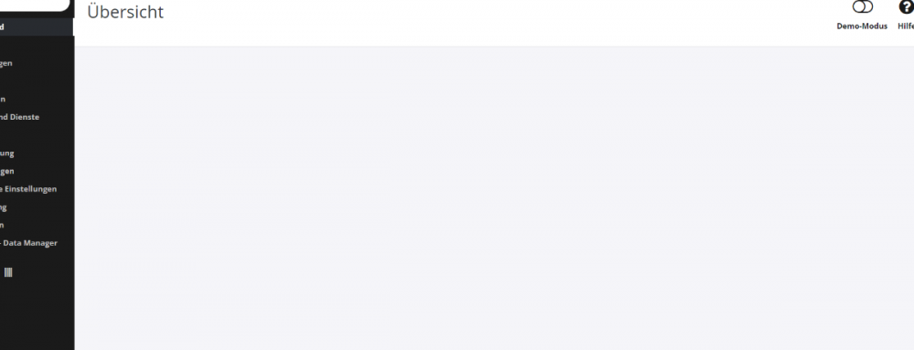

I just updated to the latest bleeding edge version and now on my dashboard there is nothing displayed. just an empty site.
Any ideas?

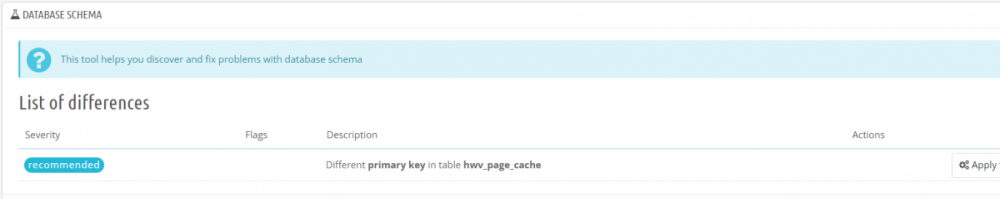

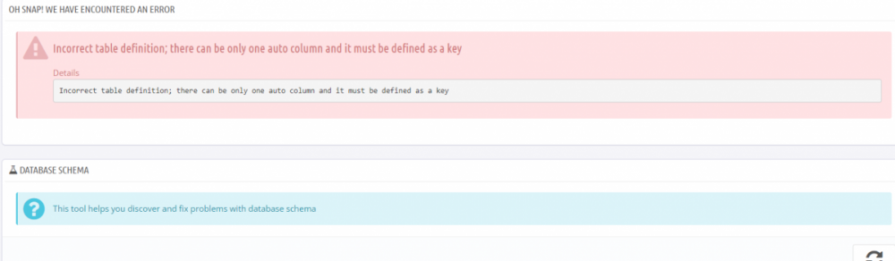

I also have his Database problem? but when i click apply, there isn´t a solution, but an error.
Update: Almost on every page nothing is displayed
Edit: rolling back to stable version fixes the issue. But it is maybe a bug in latest bleeding edge version. I did the update from bleeding edge version circa a month ago

1) Dashboard not visible after update -- I can't confirm. I just updated my test and production env to bleeding edge, and have no problem. You will need to look into your server error logs to see what is there. Also, what php version are you using?
2) Regarding DB schema problem with auto-increment column migration -- as @wakabayashi, this is known issue, and will be fixed in upcoming version of the core updater

767521917_Screenshot2022-04-27at08-55-17CoreUpdater.thumb.png.15f07ade36f2b24d559fb6cedf134655.png
Coreupdater didn't add that column, neither displayed option in database schema due to missing line in my override 🙂
I do all my updates on backup copy of shop first, to eliminate all the possible issues (mostly no issues) and to check if my overrides work 🙂
Did you redefine the object model definition in your override?
public static $definition = [...]
If so, what were your reasons to do it?
Yes, $definition was redefined in my override and bottom line was missing.
That missing line was the cause of my error when updating, and preventing database schema to add this column 🙂
'display_name'         => ['type' => self::TYPE_STRING, 'lang' => true, 'validate' => 'isCarrierName', 'required' => true, 'size' => 64],
Edited by toplakd
We really need some better way to extend object model definition. Currently there are few methods do to it, but none of them is good enough, or work in all use cases.
I have seen full override (the one you have used) -- since this is not an extension of parent definition, it is very brittle. Another way to do this is to 'adjust' object model definition in constructor. That method works in some cases only, though.
  • Like 2
I couldn't agree more. 😎 You see I am adding a lot of PR these days. But this is out of my reach. A very very good understanding of TB and PHP is needed.

so i tried today again to update to latest bleeding edge. PHP Version is 7.4; MySQL is 5.7
opening he browser console shows this
or any other ideas, where the problem could be located?
this is what it looks like
Edited by PeterPan
@PeterPan Most likely you have override for template admin/themes/default/template/controllers/dashboard/helpers/view/view.tpl. This template is responsible for displaying the dashboard page
Look recursively in your /override/ directory for file named view.tpl
Again, investigate overrides / modules.
  • Try to disable overrides and check if dashboard works -- if it works, investigate which override is a culprit
  • Try to disable non-tb modules and check that dashboard works -- if it works, then enable non-tb modules again, and disable individual modules to figure out which one is the culprit
This is not a bug in core, it's very specific to your installation. Nobody can help you much without access to your back office and/or error logs

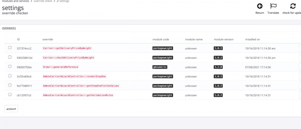

I am not good in technical details. I used prestashop 1.6 and moved to thirtybees in the end of 2019, more or less "out of the box" I did not change anything manually
Quote
Fixed.
Problem was caused by overrides from modules that were no longer installed on my system:
34566980_ModulesandservicesVerlagHoheWarte2022-06-2110-12-31.thumb.png.fe08a09450c0d4ec3aabda3f878c1625.png
Especially overrides from packageweight module caused a lot of problems, because it redefined object model definition. Core updater used this (invalid) object model definition and migrated database table to wrong / unexpected state.
Since I no longer use this module, the overrides needed to be deleted manually, and the database table to be regenerated.
Thanks for the help
