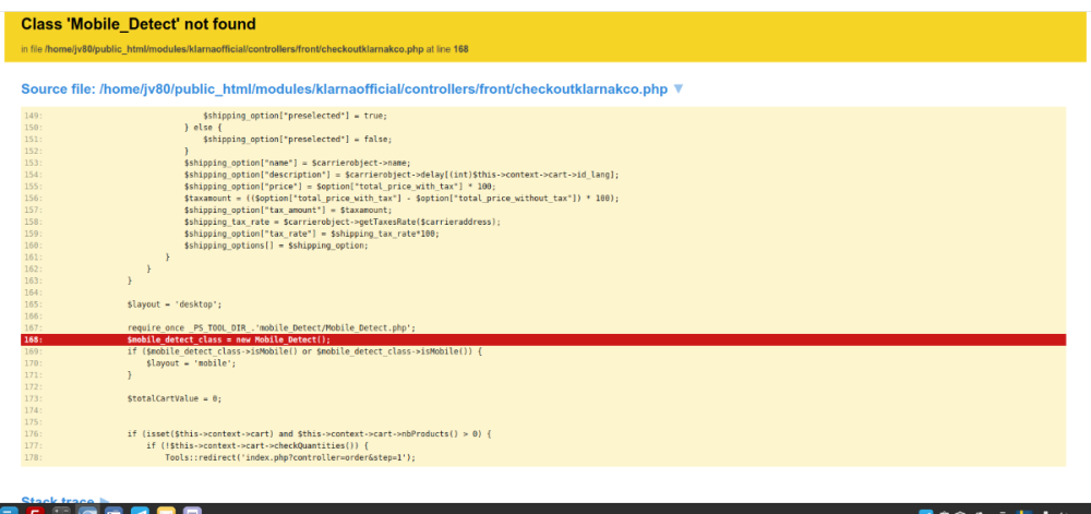

Havouza Posted July 30 Share Posted July 30 @datakickI updated one of the shops from bleeding edge that said 1.5.0 to stable 1.5.1 and get a 500 error. The decrypted error message is attached Seems something is missing Link to comment Share on other sites More sharing options...
Havouza Posted July 30 Author Share Posted July 30 I have sent the error medssage to the module author also Link to comment Share on other sites More sharing options...
datakick Posted July 30 Share Posted July 30 This is unfortunate backwards compatibility issue, but there's nothing we can do about it. Your module directly depends on old version of MobileDetect library (<3.74) -- that version is not compatible with PHP7.4 or higher. Ask the module author to use method from Context class instead. Lines 165...171 should look like this: $layout = Context::getContext()->isMobile() ? 'mobile' : 'desktop'; Link to comment Share on other sites More sharing options...
Havouza Posted July 30 Author Share Posted July 30 13 minutes ago, datakick said: This is unfortunate backwards compatibility issue, but there's nothing we can do about it. Your module directly depends on old version of MobileDetect library (<3.74) -- that version is not compatible with PHP7.4 or higher. Ask the module author to use method from Context class instead. Lines 165...171 should look like this: $layout = Context::getContext()->isMobile() ? 'mobile' : 'desktop'; We have the same module in the other shop, both with php 7.4 But we see what they answer Link to comment Share on other sites More sharing options...
datakick Posted July 30 Share Posted July 30 Just now, Havouza said: We have the same module in the other shop, both with php 7.4 But we see what they answer The only version of this library that exports \Mobile_Detect into global namespace is version 2.8.x. Library author claims, in docs and in composer package.json, that version 2.8.x supports only PHP >=5.0,<7.0. It may be that that version can actually run on php7.4 as well, I don't know. But I believe author when they say that it doesn't. Since thirty bees does not support PHP<7.4, we can't use that version of library. Link to comment Share on other sites More sharing options...

yaniv14 Posted July 31 Share Posted July 31 just edit the file your self and replace lines 165-171 with the single line @datakick mentioned Link to comment Share on other sites More sharing options...
Havouza Posted July 31 Author Share Posted July 31 36 minutes ago, yaniv14 said: just edit the file your self and replace lines 165-171 with the single line @datakick mentioned Thank you, that did the trick. I did not understand that @datakick meant to change the code. But now it works! Thanks Link to comment Share on other sites More sharing options...
