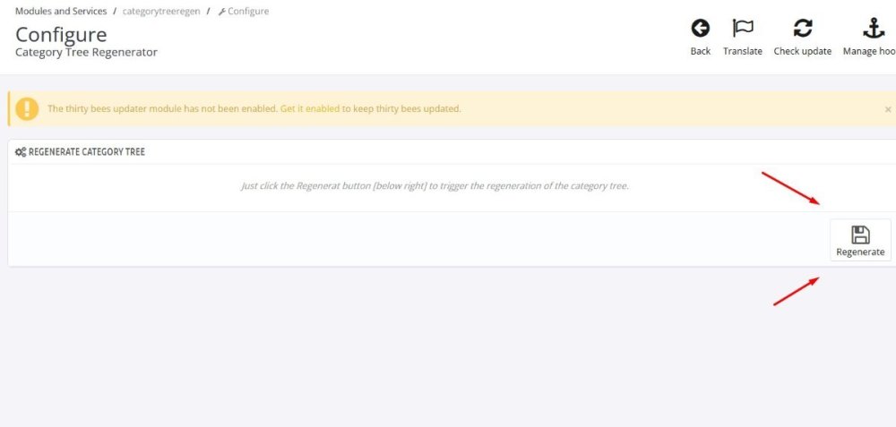

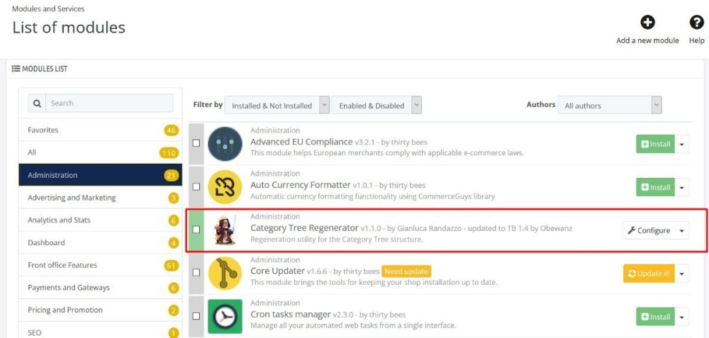

    Ok, here's the module to regen the category tree if you have the problem presented in this thread. My recommendation is that you add the module via the backoffice [Module and Services] section, click the install button, then when you click configure on the module list (after installing it), there will be a button to regenerate the category tree. That's it, nothing fancy, just regen the tree and breadcrumb malfunctions from nleft/nright not being updated when you move a category (with children - I suppose is the trigger for the bug), the nleft/nright values get reset to 0 and then regenerated using the Category::regenerateEntireNtree() class. AFTER THE INSTALL: USING THE TOOL: categorytreeregen.zip

    Thanks for putting me on the path... So, for anyone with a similar issue in the future - this appears to have been the problem. I have modified a module that will regen the tree, originally written by Gianluca Randazzo (v1.0 for PrestaShop 1.4), to work with Thirty Bees 1.4 (as version 1.1.0). As soon as I am done testing everything, I plan to upload the TB modified version to this thread (or wherever) so that others at least have a utility module that will fix the nleft/nright bug that exists somewhere in the backoffice code.

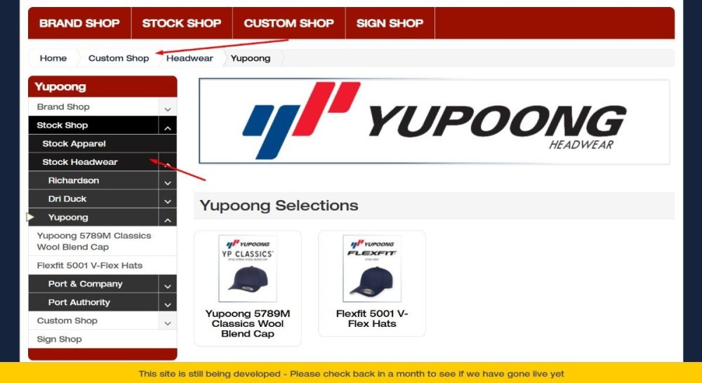

  4. Hello all, I've just recently experienced an issue with the breadcrumb generation within thirty bees 1.4. The Issue: I moved a whole category (with subcategories) of items from one top-level category to a different top-level category. Now when I browse to any of those sub-categories OR their products, the breadcrumb shows the OLD category (in the appropriate spot of the crumbs) instead of the NEW category that it should. I had this problem not that long ago, but for the life of me I cannot figure out how I fixed that one. --- Yes, I have tried purging the cache via backoffice as well as manually deleting the class_index.php file from the cache folder. It appears that the whatever is going on with the breadcrumb string, may have something to do with updating the cache, because the category menu on the left column shows the correct "tree" to the categories/products as expected. Also, I've tried restoring the original breadcrumb.tpl file as well as the Category.php and FrontController.php (which has an override to load the custom stylesheet last for css proximity) files with cache purges at each step and none of this seems to correct the breadcrumb issue. So, what am I missing? Is there another class file or something that builds the breadcrumb string that I have forgotten about or is there a caching bug in the breadcrumb routine somewhere in the code? Thanks in advance!

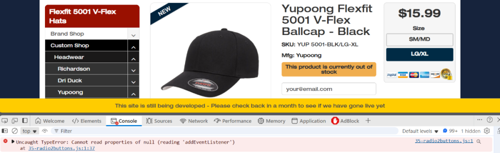

  7. Has anyone put this together for either Thirty Bees Community theme or the Niara theme? I tried to sort out what you folks did, but I've missed something along the way - buttons look good, but they are not selectable as the jscript throws an error. The Javascript in 35-radio2buttons.js (loaded from the autoload folder of the theme) document.querySelector('#buy_block').addEventListener("click", function(event) { updateLabelsSelectedClass(); }); updateLabelsSelectedClass(); function updateLabelsSelectedClass() { var attributes_options = document.querySelectorAll('#attributes input'); if (attributes_options) { attributes_options.forEach(function (element) { var label = element.closest('li').querySelector('label'); if (label) { (element.checked) ? label.classList.add('labelSelected') : label.classList.remove('labelSelected'); } }) } } The HTML output the javascript is being applied against: <div id="attributes"> <fieldset class="attribute_fieldset form-group"> <label class="attribute_label">Size&nbsp;</label> <div class="attribute_list"> <ul class="attribute_radio_list"> <li> <input type="radio" class="attribute_radio" name="group_6" value="36" checked="checked"> <label for="25" class="radio_label labelSelected">SM/MD</label> </li> <li> <input type="radio" class="attribute_radio" name="group_6" value="38"> <label for="25" class="radio_label">LG/XL</label> </li> </ul> </div> </fieldset> </div> And finally, the CSS used by a custom stylesheet loaded by the theme as the last stylesheet to load: /*style the radio button attributes - include class in template for size attributes only?*/ .attribute_list ul > li { border: 2px solid rgb(var(--color-dark-gray-rgb)/var(--color-opacity-03)); padding: 0.4rem; border-radius: 0.3rem; } .attribute_list ul > li span { margin-left:0.3rem; } fieldset.attribute_fieldset .attribute_list ul li { float:unset; text-align:center; margin:0.5rem; } /* #attributes .attribute_radio_list{ display:flex; margin:0; padding:0; list-style:none; } */ #attributes .attribute_radio {/*remove radio buttons from display*/ display: none!important; } #attributes .attribute_list ul.attribute_radio_list li{ margin-right:unset; overflow:unset; } #attributes .attribute_radio_list li:has(input:checked){ border:2px solid #002b45 !important; background-color:#002b45;color:#ffffff; }

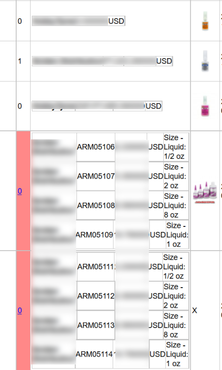

  14. It's only an indicator. When your category lists (my site has over 1,000 categories) contain as many as 500 items AND you want a quick visual scan to see if you are out of stock of anything in a particular category while preparing a purchase order, having some sort of color indicator for out-of-stock items will make it easier to spot those items for those of us with older eyes. This is the best we can hope for since there is no "desired stock level", "reorder point" or "reorder qty" fields in a product inventory or stock_reorder table. I've tried to use the "Stock Coverage" capability built into the Advanced Stock Mgmt feature of Prestashop, but to be frank, I find it woefully inadequate for the purpose it is supposed to perform. Since most people don't run stores my size, I can only assume it was more important for Prestashop to focus on making their product incompatible with previous versions - which is why I have 2 beta sites running TB. The migration of the main site I operate, which must contain all current features of the existing PS website, to TB has basically been stalled for over a year now. But I digress... Your tool has afforded a much improved ability to perform mass-edits on things, similar in outcome to what the eMagicOne PrestaStore Manager application provided in the way of inventory/stock management. It just needs a tweak here or there as I find ways to use your tool to make my ecommerce life easier! My next Prestools purchase will likely be the "special prices" plugin.
  15. Thank You. I'm pretty sure it was in some part of the product-edit.php file, but I've since closed all files related and don't really have the time to go back and sift through that code atm. I simply want to create a visual marker that can quickly identify in the product listing when an item is out of stock. I really don't want to use warehouse stock mgmt, which might actually solve this issue, but that feature seems to make everything more complicated. I don't know why these combination items have highlighting in the qty column, because none of the single items in this category do. I've also noticed yellow previously but haven't been able to locate any lists that have that qty coloring so far since the newest upgrade. (Not sure the latest upgrade has anything to do with that, just mentioning it in case it jogs your memory about something.) I'm using your tool to manage a database of 20k plus products in place of the eMagicOne PrestaStore Manager software. I have tried to reactivate that software on my new laptop, but they have stated I must essentially purchase the software again, even though my current license is a 2-seat license and supposed to be "lifetime". They're based in Ukraine, so no point in trying to pursue any other action than ending the use of their software. The Prestools product has been helpful in numerous ways to this end, but so far, it's been some of the "little things" that have been the stumbling block to meaningful utilization in this endeavor.
  16. Is there a way to add a color to the block where qty is displayed if the quantity value is 0 or less? ...or maybe pink if it is less than qty 1, and green if it is 1 or greater? I found a "lookup" in the code for what appears to be "remaining quantities" but not quite sure how that does anything, and since I don't believe that it's related to the point, I just moved on.
