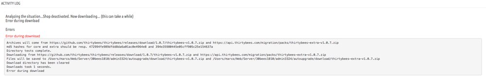

marcosig Posted October 4, 2018 Posted October 4, 2018 Hi, I’m trying to migrate from Prestashop 1.6.1.18 to Thirty Bees 1.0.7 on a local MAMP server website but I'm getting an 'Error during download' message. Can anyone help? Thanks
0 Traumflug Posted October 4, 2018 Posted October 4, 2018 Could you give a few more details? Did the module install? Does the migration process start (panels change, a text view appears) ? What are the last messages in this text log?
0 marcosig Posted October 4, 2018 Author Posted October 4, 2018 Hi Traumflug, thanks for the reply. The modules installed correctly and the migration process starts, but after a few seconds I receive the following message in the Activity Log

0 Traumflug Posted October 4, 2018 Posted October 4, 2018 @marcosig said in Download error on local MAMP migration: The modules installed correctly and the migration process starts, but after a few seconds I receive the following message in the Activity Log Thanks, the picture is very helpful. Do you see this Archives will come from ... message? One can try to download these two links with a browser or with command line curl/wget as well. This should work, it's a plain HTTP file download. If you manage to get these two files another way, you can place these two ZIP archives manually in the location given in the message starting with Files will be saved to .... The module will find them there and use them without trying to download them again (that's a new feature of the most recent module version). It also doesn't hurt to try more than once, until the archives are there and get unpacked, the PrestaShop installation isn't changed. Perhaps Github had an outage just the moment you tried to migrate.

0 marcosig Posted October 8, 2018 Author Posted October 8, 2018 The error seems to occur during the download of thirtybees-v1.0.7.zip to the autoupgrade/download folder. The archive thirtybees-extra-v1.0.7.zip is correctly downloaded (together with thirtybees-file-actions-v1.0.7.json). Since the migration process seems to delete the contents of the autoupgrade/download folder before attempting to download the archives, it's useless to manually place them before launching the migration.
0 Traumflug Posted October 8, 2018 Posted October 8, 2018 Since the migration process seems to delete the contents of the autoupgrade/download folder True. Forgot to remove this when picking this feature from module tbupdater. Here's the patch (just find and delete these four lines): ```diff // regex optimization pregmatch('#([0-9]+.[0-9]+)(?:.[0-9]+){1,2}#', _PSVERSION_, $matches); $this->nextQuickInfo[] = sprintf($this->l('Downloading from %s and %s'), $this->upgrader->coreLink, $this->upgrader->extraLink); $this->nextQuickInfo[] = sprintf($this->l('Files will be saved to %s and %s'), $this->getCoreFilePath(), $this->getExtraFilePath()); - if (fileexists($this->tools->downloadPath)) { - Tools::deleteDirectory($this->tools->downloadPath, false); - $this->nextQuickInfo[] = $this->l('Download directory has been cleared'); - } + $report = ''; $relativeDownloadPath = strreplace(PSROOTDIR, '', $this->tools->downloadPath); if (ConfigurationTest::test_dir($relativeDownloadPath, false, $report)) { $timestamp = time(); $res = $this->upgrader->downloadLast($this->tools->downloadPath); ``` This will also go into the next release, of course.
0 marcosig Posted October 8, 2018 Author Posted October 8, 2018 Got it! Removing the 4 lines and manually adding the archives worked out. Now we can roll up our sleeves and seriously plan our migration. Thank you so much.
