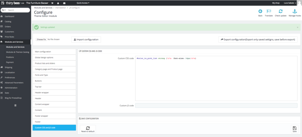

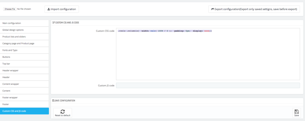

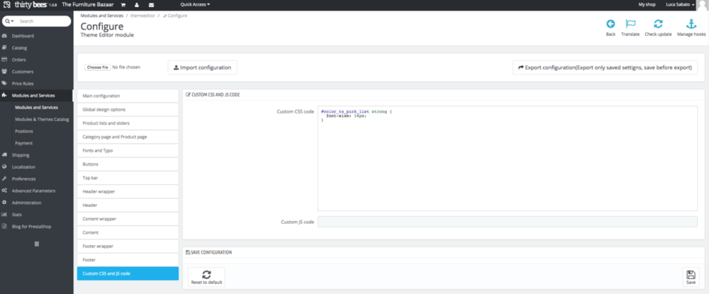

Tb 1.0.8 updated from a fresh install of tb1.0.7 with warehouse theme I have the same issue:
On the theme module when I try to update the CSS code form this :
1032294963_ScreenShot2019-03-21at10_41_40.thumb.png.737dedeb1a34b64b693856a1d18e8a4e.png
after I save the code change to :
343164311_ScreenShot2019-03-21at10_41_59.thumb.png.32bf3f6cb6b4eda1cfaec4b06b79c887.png
any idea?
