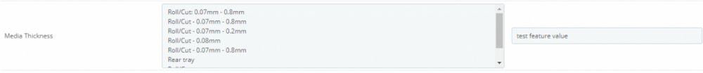

On a product features tab, enter a customised value:

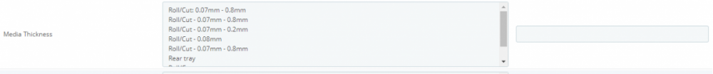

After save, value remains blank, like it did not save:
