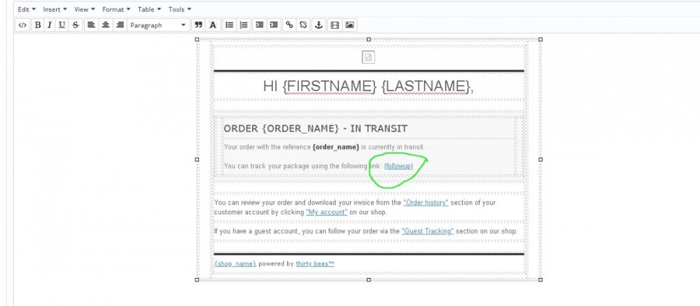

I have some working modules for shipping. Now I need to edit email which is sent to customer and I need that there is link with tracking code to webpage. Webpage address is in database. Tracking code is also in database. Which file I need to modify that client can get correct link to this webpage. At the moment client get only webpage with all additional (for example in the end is "&trackingcode="), but not tracking code itself in this link. How can I complete this link ?

Well. The link in email (which is sent to customer) contains almost all necessary information. Almost. And I couldn't find place where can I edit this. In translation page this link is called (followup), so this link is constructed in somewhere. And I could not fin this place. When I can modify what is inside this (followup) then I think all is OK.
I think that's a template variable. I can see that several .tpl checks if it's set.

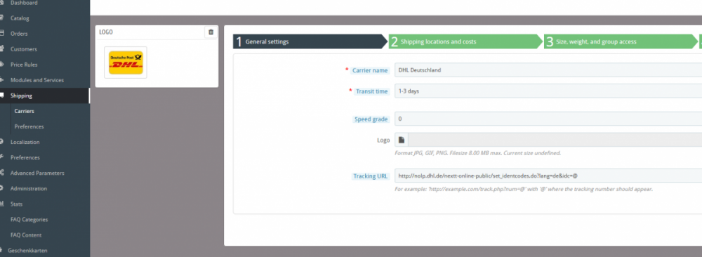

For Germany with shipping via DHL and other logistics companies, it looks like this (tb standard without extra module)
This @ should be do all the "magic", but in real life it does nothing. Client email still ends exactly at the point where tracking number begin.
Well. Finally. But I have strong feeling that this can cause error in some other place. Shortly, file AdminOrdersController.php contain puiblic function - postprocess And there is place where the content of this (followup) is constructed. There is line 613 where is $_order, but this must be $_orders. Because in my system there isn't table with name order, but orders. I replaces this one and at the moment the result is exactly what I need. Client can have email with link that opens right page with tracking result and not a blank page where You must insert tracking number. This is TB1.0.x - bleeding edge. I hope this will help somebody.
EDIT. I think that there is no need to modify anything. There wasn't @ symbol (See colorful-ant reply) and after I put  this symbol then I didn't wait long enough for system to compile new files with changes. So if You put @ then you need empty cache and wait little bit.

This did help and I already find out what was wrong in my case. And yes, You need manually enter tracking code to order. My problem was this @ sign.
