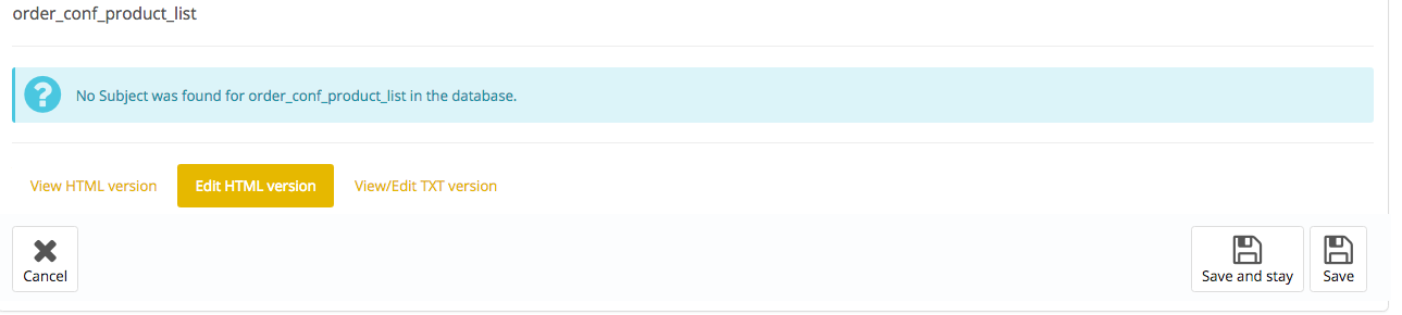

vzex Posted June 30, 2017 Share Posted June 30, 2017 Unable to use html edit orderchanged to remove powered by PS "No subject was found for orderchanged in the database" The following were blank: Link to comment Share on other sites More sharing options...

0 vzex Posted July 1, 2017 Author Share Posted July 1, 2017 @Occam said in Email translations No subject was found in the database: Seems there was a problem with the installation process. Can you confirm that there exists a subdirectory /mails/ at all? I'd guess no. Mine does exist: mails/en My installation was a clean install via cpanel If the subdirectory would exist, tb will accept the changes and clone the changed mails directory to /themes//mails/, where it will be searched automatically in case of further changes. Solution: Go to localization --> translations --> section: Add / Update a language and import your language. Then try again to modify the mails. Will this solution overwrite all the "powered by prestashop" I've already edited out? If it will should I just replace the three emails from a new copy of TB? orderchanged orderconfproductlist orderconfcat_rules Link to comment Share on other sites More sharing options...

0 30knees Posted December 11, 2017 Share Posted December 11, 2017 I'd like to piggy back on this thread, as I'd have the same thread title. I would like to change the subject of an order status email. I get the same "No Subject was found for bankwire in the database" error when I click the order status to translate. I have it in my themes/theme/mails/language folder. Where can I change the order status? I am assuming I can change the name of the order status in Orders>Statuses, but I'd like to keep that one shorter/different (for usability purposes in the backend) than in the email subject. Link to comment Share on other sites More sharing options...

0 30knees Posted November 11, 2023 Share Posted November 11, 2023 On 7/25/2018 at 3:53 PM, DaoKakao said: Finally i've found a solution for that issue: https://github.com/thirtybees/mailalerts/issues/3 The mailalert.php is correct in my store but I am still unable to edit some subjects. What is the solution? I get: No Subject was found for bankwire in the database. Link to comment Share on other sites More sharing options...
0 datakick Posted November 22, 2023 Share Posted November 22, 2023 On 11/11/2023 at 12:53 PM, 30knees said: The mailalert.php is correct in my store but I am still unable to edit some subjects. What is the solution? I get: No Subject was found for bankwire in the database. Email subjects for order status emails are not translatable in the same way as other emails. Thirty bees collects information about email subject by parsing source code, and looking for pattern Mail::Send($languageId, 'email_template', Mail::l('Email Subject')) When it sees such code, it can associate email template 'email_template' with default subject 'Email Subject', and offer translation for it. The important think is that the email_template and Email Subject are literals - constant values. This works for static emails only, the one that are know at the time when developer writes code. For order status that's very different. You can specify which email template should be sent dynamically (edit order status). The code to send email looks like this (using variables) Mail::Send($languageId, $status->template, $status->name); The translation system can't work with that, so nothing is offered for translation. When sending emails for order statuses, order status name is always used as email subject. Bleeding edge (1.6) contains new enhancement that let you have explicit email subject for each order status. Link to comment Share on other sites More sharing options...
