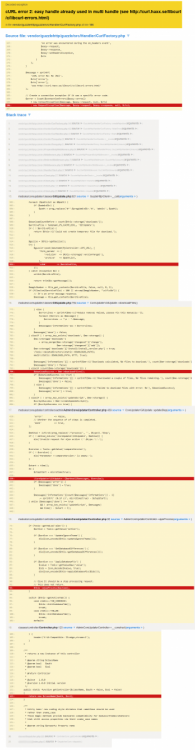

Hi guys, I have this error in my store upgrading from 1.1.0 to 1.2.0 (cpanel, centos 6, php 7.3, curl 7.76 -latest-, coreupdater 1.3.3 -latest-)
*ERROR*     2021/04/05 - 12:03:07: cURL error 2: easy handle already used in multi handle (see http://curl.haxx.se/libcurl/c/libcurl-errors.html) at line 186 in file vendor/guzzlehttp/guzzle/src/Handler/CurlFactory.php
Can you help me? Thank you in advance. (sorry for my english)
Edit: image in full size: https://postimg.cc/tsjPgGbX
Edited by signcoders
Link to image added
