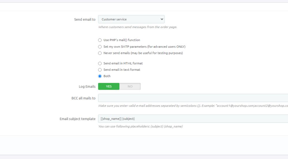

the.rampage.rado Posted March 9, 2024 Posted March 9, 2024 That's strange I just rolled back my test setup to 1.4 just to confirm and take a screenshot. Probably your module list is cached!? Those two additional modules are extracted functionality form the core. In 1.4 the email config is here: And those modules have nowhere to hook to work. You have to update to 1.5 and this functionality change is just one of the nice features that come with this version.
