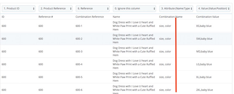

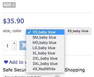

alwayspaws Posted October 10, 2017 Posted October 10, 2017 How do I make size and color choices easier for the customers to read?
Baarssen Posted October 10, 2017 Posted October 10, 2017 Its a long list because you combined the attributes. It should be easier if you splitted it into 1 attribute for size, and 1 for color. Maybe you will have to do this manually. Maybe its some work, but it is a 1 time job, after that your attibutes are stored and you can use them any time. In my webshops i also use lots of color and size attirbutes, and i have splitted them into 2 attributes. Some products of me have more then 5000 combinations.

alwayspaws Posted October 10, 2017 Author Posted October 10, 2017 @Baarssen I only use spreadsheets, but if you go to the BO - CSV import - combinations import - you can see the choices there.

jnsgioia Posted October 10, 2017 Posted October 10, 2017 I checked your site and the items you listed a while ago have the size and color split. The newest ones have them as one item. Did you change your csv file format recently? If you are using a , as the multivalue separator it should import your size and color as two attributes not one. Your file looks like mine except I use ~ as my multivalue separator.
alwayspaws Posted October 10, 2017 Author Posted October 10, 2017 @jnsgioia Thanks. I should have referred you to my screenshot in the beginning of my post. It shows the csv with the comma multivalue separator. The products you viewed only have a few choices. I changed and successfully have been using my csv for a long time. Nice to see you ?
alwayspaws Posted October 11, 2017 Author Posted October 11, 2017 These products have many more colors and each have all the sizes. I've been using a comma as the multivalue separator and comma to separate the attributes.

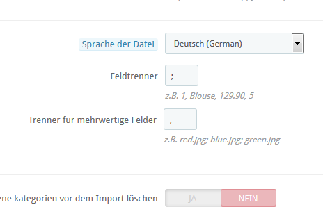

zimmer-media Posted October 11, 2017 Posted October 11, 2017 @alwayspaws hi stephanie try this for example variante (attrribute) wert (value) farbe (color) größe (size) select - is dropdown-option csv-import-option i use comma and semicolon
alwayspaws Posted October 11, 2017 Author Posted October 11, 2017 @zimmer-media Thank you for your time and effort! I still can't get it to work. I separated the variante (combination attribute) with a comma: size, color wert (combination value) size and color is XS,baby blue (no separator in between size and color) Dropdown is set up for all my attributes. Field separators for the import are comma and semicolon. I'm doing this on my test site, btw. With a comma between the combination values of size and color: Test product:
alwayspaws Posted October 11, 2017 Author Posted October 11, 2017 @lesley @mdekker @Traumflug @wakabayashi I think we have a bug in the csv imports. Screenshot: I used the same exact csv and the old product page is correct. I changed the ID # for the new upload to #700. The new product page is wrong and so are all the newest products I have uploaded that have combinations sizes and colors. Here is the csv file I used and all I did was change the Product ID 01507730688780test-10-11-17.csv

jnsgioia Posted October 11, 2017 Posted October 11, 2017 @alwayspaws When I went to open the csv file in libreoffice calc it showed that the file has the field separator as a comma as well as the multivalue separator. I opened it in notepad and it does have the field separator as a comma.
