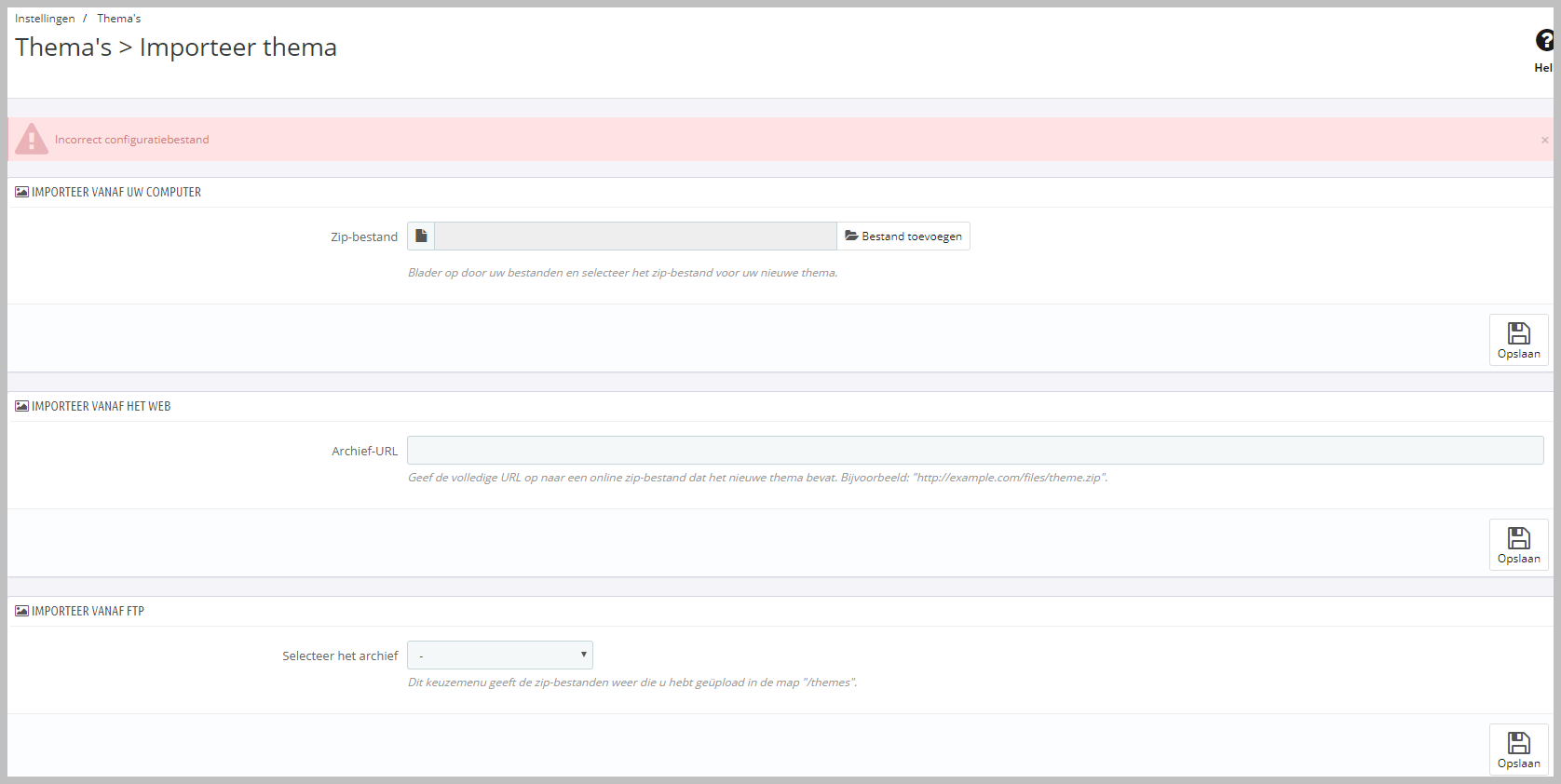

Baarssen Posted August 21, 2018 Posted August 21, 2018 When i try to upload a theme in 1.06 i get the message: incorrect/bad configuration file. It doesnt matter what theme i use. Also when i do the procedure by ftp (zip file). I also unzipped it and zipped it again. No luck. I tried several themes, including warehouse 3.8.6 and 3.8.7 Any idea what i do wrong?

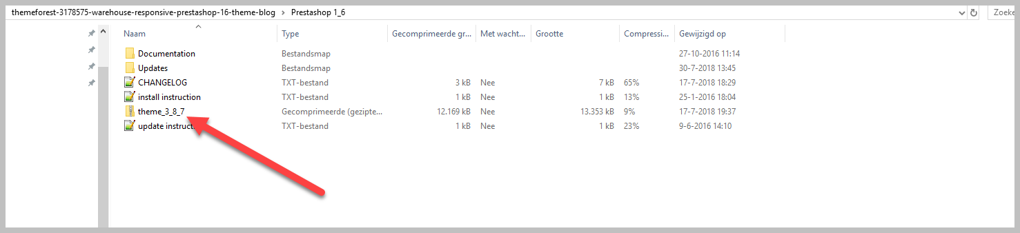

0 Baarssen Posted August 21, 2018 Author Posted August 21, 2018 yes, i did. I know sometimes in the zip is another zip, but i always check this:
0 doclucas Posted August 22, 2018 Posted August 22, 2018 I have the same problem on TB 1.0.6 on my Linux server. It says Bad configuration file. However, when uploading the same exact theme file to TB 1.0.6 on my windows server (WAMP) it works perfectly. @Traumflug - any way to debug what's causing this?
0 doclucas Posted August 22, 2018 Posted August 22, 2018 @Baarssen @Traumflug Found the problem. Edit controllers/admin/AdminThemesController.php Change: $xmlFile = $sandbox.$themeDir.'/config.xml'; to $xmlFile = $sandbox.$themeDir.'/Config.xml'; That's Config with a capital C. Hope this helps. :) On git: https://github.com/thirtybees/thirtybees/issues/579
