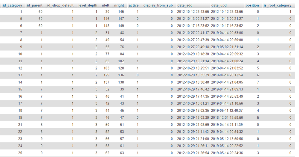

I will add the screenshot from my database below. As far as I can see I am using the home as the root categorie en that's why I can't choose the Home as the main category.
I want to add a domain with the same products, categories and theme, just an other country.

It looks like I am using Home as Root?
1 is not always the root. When you have an upgrade from Prestashop 1.4 "1" is Home and the root has some high id number. In 1.4 Home was the base level. In 1.5 multishop was introduced and Root was added to come under the Homes of the different shops. Given that id_category is an auto-increase field that meant that it got the next free id_category.
So my guess would be that 60 could be your Root. But you don't show it so we can't see its parent.
