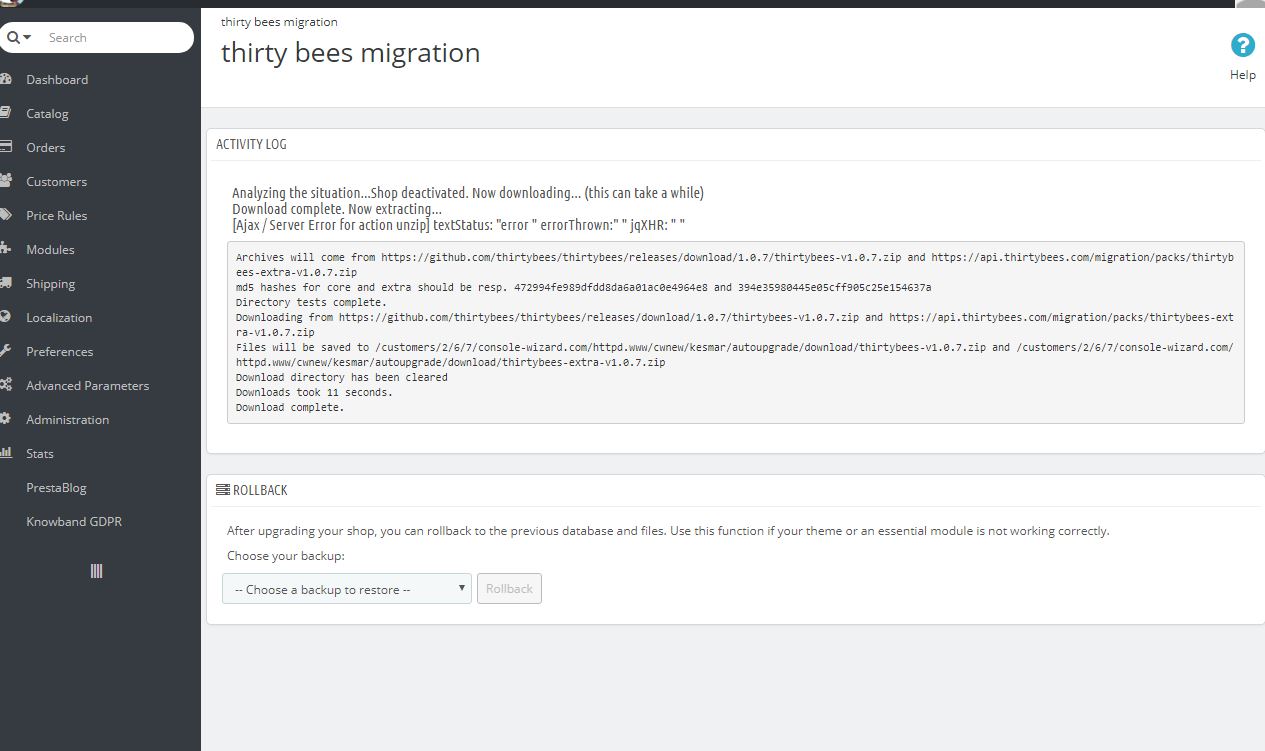

Can anybody please help me, I have spent the entire evening trying to upgrade from PS 1.6.1.22 to TB 1.07 using the latest TB updater. The process starts and after downloading TB and then extracting it stops with an error
Ajax / Server Error for action unzip] textStatus: "error " errorThrown:" "jqXHR: " "

Even better, on server OSs other than Windows, these 30 seconds are just processing time, not I/O waiting time. Which means, slow downloads don't require raising these 30 seconds. In my development setup I have set these 30 seconds and a download taking 40 or 50 seconds (slow Github) works just fine. In your case, downloads took just 11 seconds, see the activity log in your screenshot.
That said, downloads aren't the problem. The problem is a) unzipping the release package and b) no error message.
Does this step actually take like 50 seconds? Or does it return much earlier? It's hardly imaginable unzipping a 40 MiB package takes 50 seconds on modern hardware. 1 or 2 seconds are more typical.
