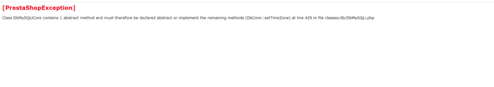

rubben1985 Posted March 26, 2020 Author Share Posted March 26, 2020 (edited) Thanks! I have tried to install the module but it gives me an error: What is the difference between the free and premium version of this module? I do not see any in the modules descriptions (it could also represent people not buying the premium one for this). last question: do you have a test environment for your premium reviews module? It may interest me but I would like to see it in action (how it looks the emails and interaction with them, how it looks the store review section...). Regards NOTE: Also, just in case it is an error, just leeting you know that your service support is not available in your store (either the migration service) Edited March 26, 2020 by rubben1985 Link to comment Share on other sites More sharing options...
datakick Posted March 26, 2020 Share Posted March 26, 2020 1 hour ago, rubben1985 said: Thanks! I have tried to install the module but it gives me an error: I suggest you install my other module called Consistency. It can detect some weird stuff. This one would be detected. There is extra file DbMySQLi.php in classes/db directory. It shouldn't be there. Thirtybees autoload mechanism can load any php file in classes/* directory, and then anything can happen (but nothing good). Like this error here. I suggest you delete this file immediately 1 hour ago, rubben1985 said: What is the difference between the free and premium version of this module? I do not see any in the modules descriptions (it could also represent people not buying the premium one for this). In free version, you can define two rules. Premium version allows unlimited rules, obviously. 1 hour ago, rubben1985 said: last question: do you have a test environment for your premium reviews module? It may interest me but I would like to see it in action (how it looks the emails and interaction with them, how it looks the store review section...). Sure thing. You can login to my demo account and test it out. http://demo.getdatakick.com/admin561wkvz9k/ 1 hour ago, rubben1985 said: NOTE: Also, just in case it is an error, just leeting you know that your service support is not available in your store (either the migration service) No, it's not error. I don't offer support / development packages at the moment, as I'm nearly 100% utilized. I might offer these services in the future when I'm done with current development project Link to comment Share on other sites More sharing options...

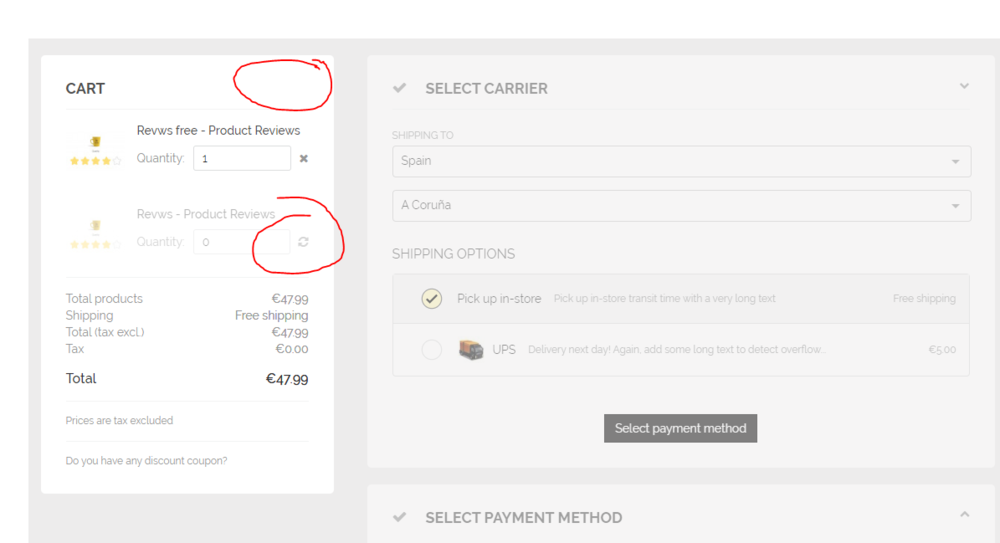

rubben1985 Posted March 26, 2020 Author Share Posted March 26, 2020 I was trying to test but I could not do it properly: - no access to settings options in the back office - I can not place an order (in free order stripe button do not works so order is not finished) to see how emails are My two cents to improve checkout: as I tried to place an order i used the checkout. If that helps, It was very difficult to find how to modify the cart. The "done" is not very intuitive, and in addition it dissapear when the mouse is not on the section. I would just avoid the "done" and directly accept modifications or make a very visible button that says "confirm modification" Link to comment Share on other sites More sharing options...
