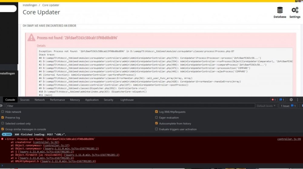

musicmaster Posted October 10, 2021 Posted October 10, 2021 2 hours ago, datakick said: Did the ajax request failed, or just took a long time to process? I had it once again running and got this. I am afraid it is not a good idea to have so many ajax calls (the counter is here at 1684). On Windows computers they attract anti-virus checks and as a consequence they are slow.
