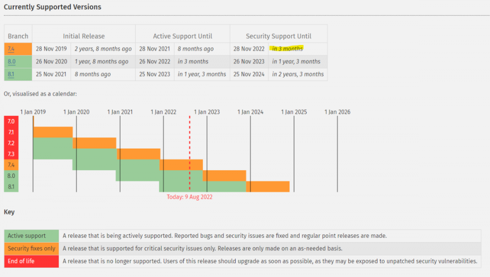

I just wanted to add the important php graphic, to illustrate that this issue has not so much todo with TB:
So very soon php7 won't be supported anymore. It means the same trouble for all prestashop 1.6 shops. If you are lucky, some module devs still fix their modules. If not, you should either look for an alternative module or let it fix. I have no experience in this, but I would expect that most modules can be fixed in 1-2 hours. Ofc I might be wrong.
