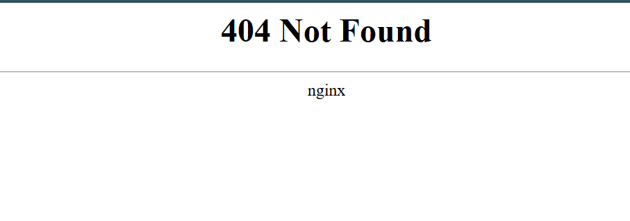

0 Madhosh Posted June 6 Author Posted June 6 Please help : I landed up in another problem. My shop gives I have checked the data base password is correct in settings file.
0 Madhosh Posted June 6 Author Posted June 6 53 minutes ago, the.rampage.rado said: Which page is that? Homepage? Can you open your BO? BO has a password problem. As Instructed, I changed inserted the php file. The force Login works and after that i followed the steps but i can't change the passoword. Neither i am getting any E-Mails on resetting password. Thats my FO. PS: I tried to update the password in myPHP Admin using the key and password but it didnt help.

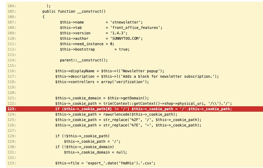

0 Madhosh Posted June 7 Author Posted June 7 I have following error in one of module before I install phpmailer. Can you please help?
0 datakick Posted June 7 Posted June 7 That module is not php8 compatible. You should probably stop using it, or ask author for a new version, or hire somebody to fix it for you. In this particular case, the fix is very simple. Replace the if ($this->_cookie_path{0} != '/') $this->_cookie_path = '/'.$this->_cookie_path; with if ($this->_cookie_path[0] != '/') $this->_cookie_path = '/'.$this->_cookie_path; But who knows how many other issues that module contains. 1

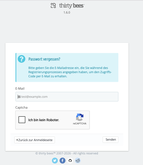

0 Madhosh Posted June 7 Author Posted June 7 I installed the phpMailer and sent the test email it works. I still don't get my old password. How can I recover it?
0 datakick Posted June 7 Posted June 7 System doesn't know your password. We only stores it's hash -- there's no way to determine your password from that. You can use 'I forgot my password' functionality on your back office login page to generate a new password.
0 Madhosh Posted June 7 Author Posted June 7 I did that but it doesn't send the password to my email. I checked the mail log as well.
0 DRMasterChief Posted June 7 Posted June 7 (edited) I'm not entirely sure, but you might be able to change the email address in the database to one that definitely works, and then use the "forgot password" function on the back-office login page. Come on, we're going to end up with a complete guide here 🙂 Edited June 7 by DRMasterChief 1
