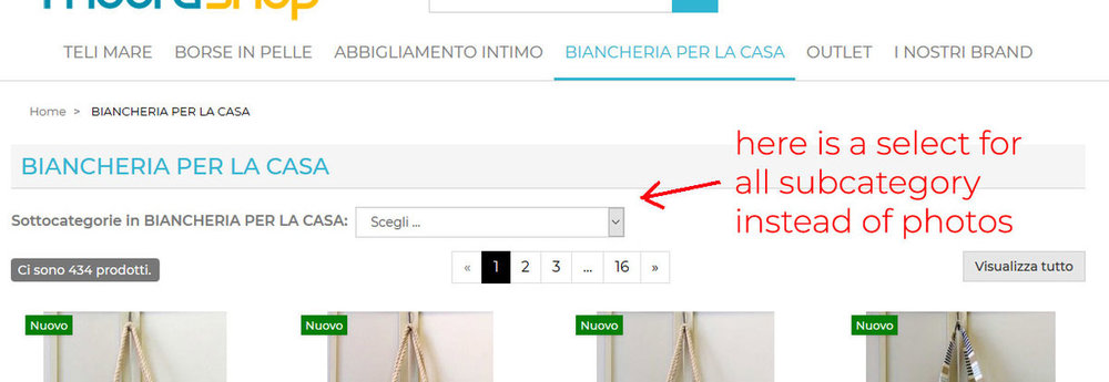

ariom Posted July 29, 2019 Posted July 29, 2019 (edited) @dynambee this was my solution to the same problem ... if i understand it right :) but i did on TB 1.08 with a modified copy of community theme default , i don't know for niara theme and TB 1.1 ... if you like my solution i can upload a copy of the modified category.tpl to make a compare vith the same on niara and maybe do yourself the needed change (its very simple change) Edited July 29, 2019 by ariom
