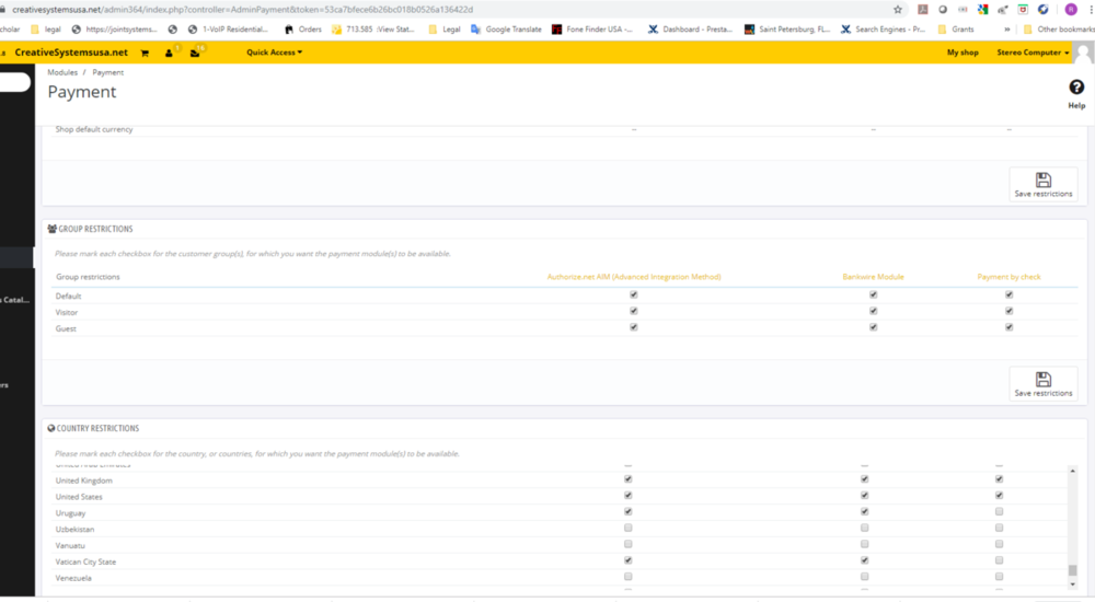

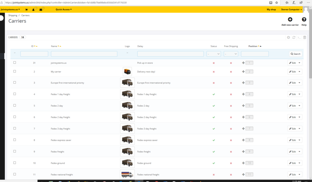

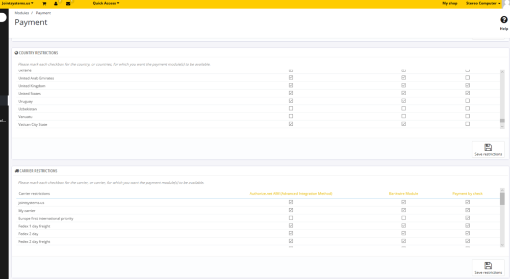

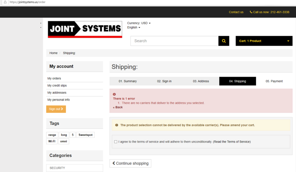

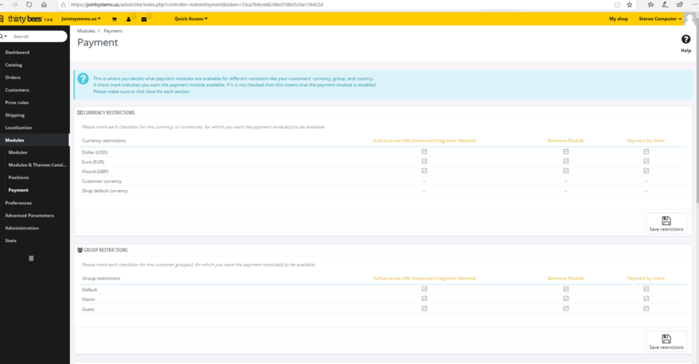

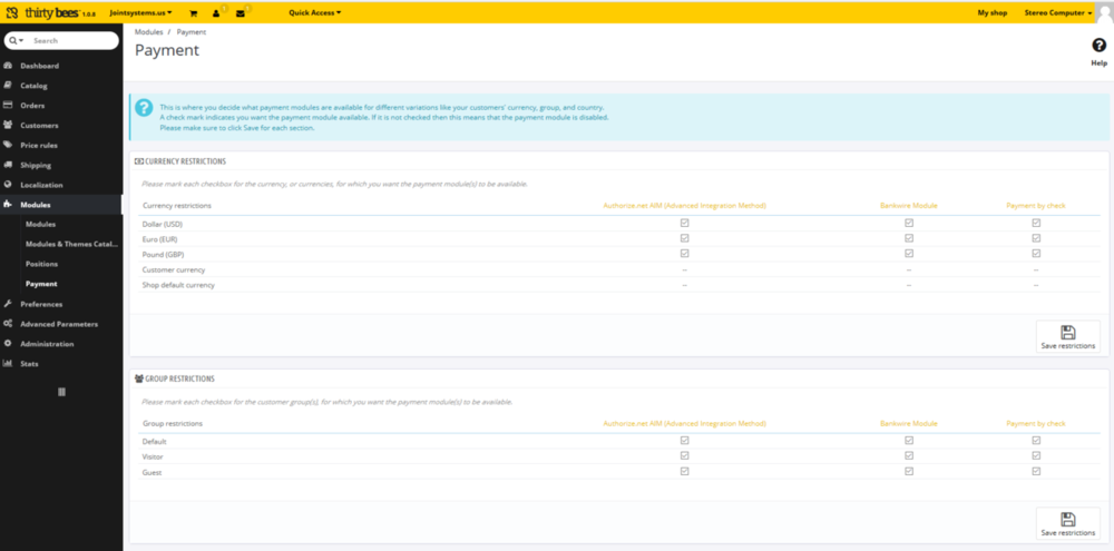

 The customer address does not save at jointsystems.org or jointsystems.org/shop.  The address does save at jointsystems.us but the carriers for the US despite being enabled in the admin do not work?

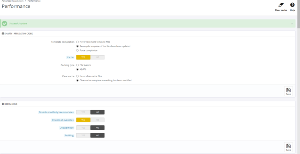

Both the carriers and the CC choice for credit card showed up after I made some performance changes such as reengaging the cache but in the sql mode and enabling non-TB modules (which would only have been prestashop modules.
Both the carriers and the CC choice for credit card showed up after I made some performance changes such as reengaging the cache but in the sql mode and enabling non-TB modules (which would only have been prestashop modules. But if they disappear again or have the same problem on a new installation (I just did) I will follow your advice.  After I got the addresses up and processed a test payment I am  getting the error "Authorize.net returned a malformed response, aborted" have an idea what causes that.  It happens at Hostwinds but not hostgator though Hostwinds says the sever is configured correctly as per prestatools listing requirements.
