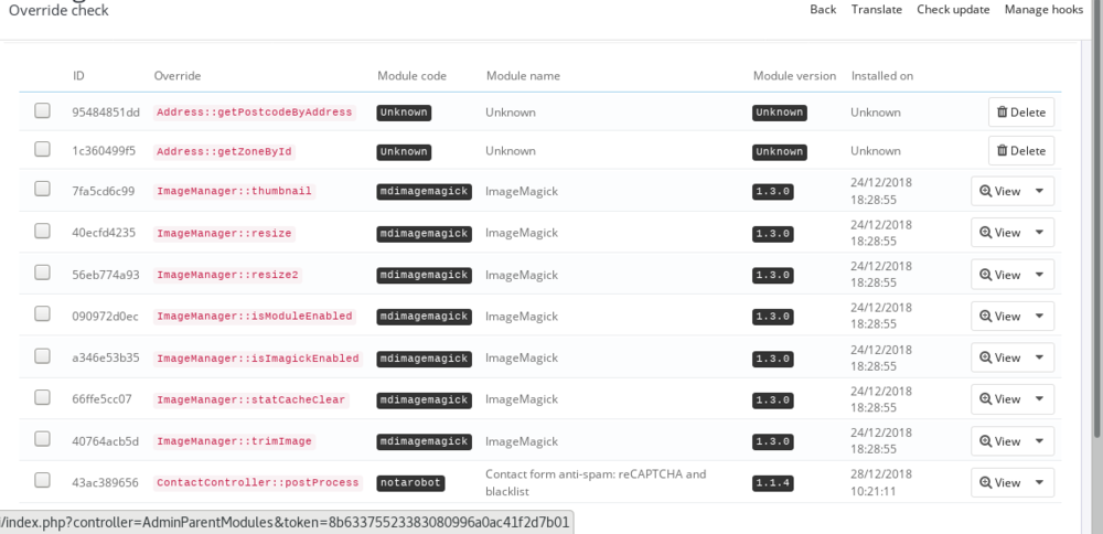

datakick Posted March 16, 2020 Posted March 16, 2020 You should also install Override Check module to see what overrides are installed on your system 2
Chandra Posted March 16, 2020 Author Posted March 16, 2020 Not many related ones, really. Now I will stop to bug you and report back once I have the next order.
