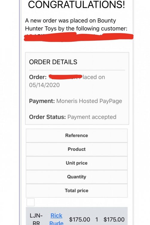

When an order was placed in the past, the customer and myself would get a copy of the email, and I would also get an email when something is out of stock.
They're getting their email... I'm not getting any of mine

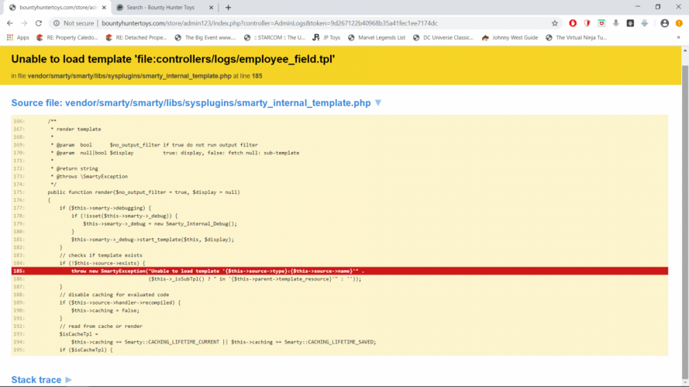

When I check logs, I get a 500 server error? (Pic attached)
I did switch themes last week, but switched it back.
When I turn on Debug mode. This is the error that appears instead of the 500 screen.image.thumb.png.0a087de2559b8790853bd6b5cc6e9e81.png

Regarding your other problem -- you have incomplete installation - file admin-dev/themes/default/template/controllers/logs/employee_field.tpl is missing. Fix the installation using core updater.

Downloaded the core updater. Installed it. and the log error is now gone.
