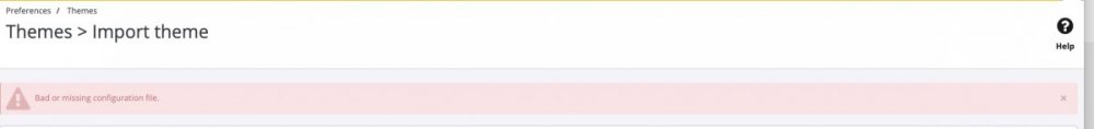

purechoice Posted September 4, 2020 Posted September 4, 2020 I just installed 1.0.8 and bought Panda. When I go to preferences--themes and add theme I get Bad or missing configuration file. I tried he TB version the 1.6 and the 1.7 one. All the same error. I even tried to do it through FTP but it does not show up in my themes. Anyone know whats wrong?
0 datakick Posted September 4, 2020 Posted September 4, 2020 First update to latest version of thirtybees, ideally 1.1.x - bleeding edge. It might sound scary to newcomers, but it's the most stable of them all. If it still doesn't work on latest version, file a bug on github.

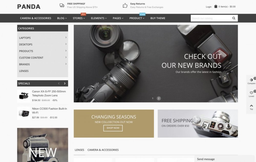

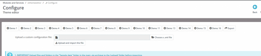

0 colorful-ant Posted September 4, 2020 Posted September 4, 2020 (edited) i have a store with tb 1.0.8 - need more time to update it to "tb bleeding edge" (my own changes) i use it with panda it works and another little store with tb bleeding edge and new panda version works without problems edit - image tb 1.0.8 - with panda tb version Edited September 4, 2020 by colorful-ant

0 colorful-ant Posted September 4, 2020 Posted September 4, 2020 disable and clear caches - etc try again i think its another problem with your theme install Bad or missing configuration file
0 purechoice Posted September 4, 2020 Author Posted September 4, 2020 yep done that also 😞 I tried downloading the theme again and also tried the FTP method. No go either way,
0 purechoice Posted September 4, 2020 Author Posted September 4, 2020 Just tried the coreupdater also, but no change
0 datakick Posted September 4, 2020 Posted September 4, 2020 1 minute ago, purechoice said: I saw this but I have 1.0.8 so it still should not be a problem 1.0.8 is not latest version, far from it. And this version had few bugs regarding theme installations. Some of them were fixed or mitigated in 1.1.0 and 1.1.x. That's why I asked you to update to latest version -- it's possible your issue is already solved.

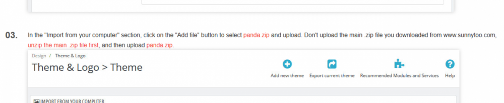

0 colorful-ant Posted September 4, 2020 Posted September 4, 2020 have you read the install informations from @Jonny sunnytoo.comhttp://panda2.sunnytoo.com/doc/

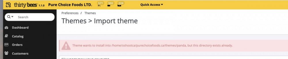

0 purechoice Posted September 4, 2020 Author Posted September 4, 2020 OK, looks like I am getting somewhere now that I am at 1.1.0 . I have to ftp in delete the panda thats there and try again.
0 purechoice Posted September 4, 2020 Author Posted September 4, 2020 BINGO!! thats did it. its installed. Now I will see what other trouble I can get into. Thank you all fro your help. Solution- You need 1.1.0 . 1.0.8 does not work.
0 datakick Posted September 4, 2020 Posted September 4, 2020 I see that your site does not look so good. Looks like your modules were disabled / unhooked. You will need to go to Modules and reset each and every one of them, so they re-hook properly. This is one of the issues that was (to some level) fixed in 1.1.x. Too bad you updated only to 1.1.0.
0 purechoice Posted September 4, 2020 Author Posted September 4, 2020 is there a way to just have this site?
0 colorful-ant Posted September 4, 2020 Posted September 4, 2020 you can try different versions/designs from panda theme or find one -> then change it to your wishes please read here:http://panda2.sunnytoo.com/doc/ 1
