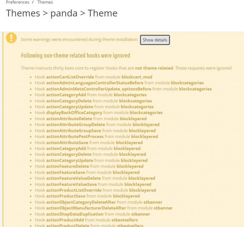

musicmaster Posted August 1, 2022 Posted August 1, 2022 When I install the Panda theme on a TB 1.3 installation I get the following warning: Following non-theme related hooks were ignored. I never before saw such a thing. How should I understand this? Does this affect the working of the theme?

datakick Posted August 1, 2022 Posted August 1, 2022 These warnings exists to inform user that the theme tries to hook / unhook nondisplayable hook. Take hook actionFeatureSave from module blocklayered as an example. This module use this hook to react on a situation when feature is saved to database in order to rebuild its cache. Why should installation of a new theme disable or enable this functionality, which has absolutely nothing to do with theme? The reason why your theme looks 'weird' after installation is that it did not provide valid set of displayable hooks that should be hooked/unhooked via its xml file. Thirty bees did not know what to do, and therefore did nothing.

musicmaster Posted August 1, 2022 Author Posted August 1, 2022 11 hours ago, datakick said: These warnings exists to inform user that the theme tries to hook / unhook nondisplayable hook. Take hook actionFeatureSave from module blocklayered as an example. This module use this hook to react on a situation when feature is saved to database in order to rebuild its cache. Why should installation of a new theme disable or enable this functionality, which has absolutely nothing to do with theme? The reason why your theme looks 'weird' after installation is that it did not provide valid set of displayable hooks that should be hooked/unhooked via its xml file. Thirty bees did not know what to do, and therefore did nothing. Yes. I am afraid that it is something like that. I checked my migrated shop and I saw that it has 63 modules with Prestashop as author and only 2 modules with Thirty Bees as author. I haven't checked yet but I am afraid the situation is similar with hooks. That would mean that many of the hooks that Panda assumes essential in Thirty Bees just aren't present. But that would imply that the migration module is not doing what it is supposed to do.
datakick Posted August 2, 2022 Posted August 2, 2022 6 hours ago, musicmaster said: But that would imply that the migration module is not doing what it is supposed to do. That's not how hook works, there is nothing to migrate. Hooks records are created on the fly, either explicitly (definition in theme, programatically from module) or implicitly when module register hook handler using $this->registerHook('whatever'). PHP code can call any hook (even if it does not exists) by executing Hook::exec('hookname',...). The same applies to templates, where you can call hook by {h name='hookname'} syntax. If hook record does not exists, or exists but no module installs handler, this call is a noop.

musicmaster Posted August 2, 2022 Author Posted August 2, 2022 18 hours ago, datakick said: The reason why your theme looks 'weird' after installation is that it did not provide valid set of displayable hooks that should be hooked/unhooked via its xml file. Thirty bees did not know what to do, and therefore did nothing. This is the latest version of the Panda theme - the only third party theme for Thirty Bees that is still supported. That should work. It evades me why you claim that it shouldn't.

datakick Posted August 2, 2022 Posted August 2, 2022 4 minutes ago, musicmaster said: This is the latest version of the Panda theme - the only third party theme for Thirty Bees that is still supported. That should work. It evades me why you claim that it shouldn't. First of all, it does work, otherwise you would not be able to provide the screenshot 🙂 I haven't seen the theme config.xml file, so it's hard to tell what is wrong. In this config file, theme author can specify which modules should be enabled and installed. For these enabled modules, author should specify what (displayable) hooks should be registered == the hooks that are called by theme. These hooks will be enabled, all other displayable hooks not mentioned in the xml file will be disabled. If the xml file does not mention any displayable hooks for given module, no hooks of the module will be enabled or disabled. Thirty bees is doing only operations that are requested by config.xml file. You can always go to Modules, and reset various theme related modules to restore the module default hook list (not the list one specified by theme), or go to Positions and transplant one hook position to another. However, this operation should not be needed if the config.xml file is properly defined.

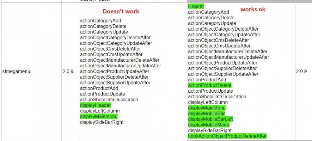

musicmaster Posted August 2, 2022 Author Posted August 2, 2022 (edited) When I use the module compare function of Prestools to compare the hooks I see this for the Stmegamenu module. I compared the shop I am working on with a shop I migrated a long time ago to TB. They use quite different hooks (all hooks that are not on the other side are highlighted). For many other modules there is a similar picture. Specially the Header/displayheader and displayMainMenu/displayMainmenu differences puzzle me. Edited August 2, 2022 by musicmaster

datakick Posted August 2, 2022 Posted August 2, 2022 44 minutes ago, musicmaster said: Specially the Header/displayheader difference puzzles me. Header is an alias for displayHeader, it exists for backwards compatibility reasons.
datakick Posted August 2, 2022 Posted August 2, 2022 If you look into Config.xml file for what it says about stmegamenu module: <hook module="stmegamenu" hook="Header" position="35"/> <hook module="stmegamenu" hook="actionCategoryAdd" position="3"/> <hook module="stmegamenu" hook="actionCategoryDelete" position="3"/> <hook module="stmegamenu" hook="actionCategoryUpdate" position="5"/> <hook module="stmegamenu" hook="actionObjectCategoryDeleteAfter" position="2"/> <hook module="stmegamenu" hook="actionObjectCategoryUpdateAfter" position="2"/> <hook module="stmegamenu" hook="actionObjectCmsDeleteAfter" position="3"/> <hook module="stmegamenu" hook="actionObjectCmsUpdateAfter" position="3"/> <hook module="stmegamenu" hook="actionObjectManufacturerDeleteAfter" position="3"/> <hook module="stmegamenu" hook="actionObjectProductUpdateAfter" position="3"/> <hook module="stmegamenu" hook="actionObjectSupplierDeleteAfter" position="3"/> <hook module="stmegamenu" hook="actionProductAdd" position="5"/> <hook module="stmegamenu" hook="actionProductDelete" position="5"/> <hook module="stmegamenu" hook="actionProductUpdate" position="5"/> <hook module="stmegamenu" hook="actionShopDataDuplication" position="5"/> <hook module="stmegamenu" hook="displayLeftColumn" position="15"/> <hook module="stmegamenu" hook="displayMainMenu" position="1"/> <hook module="stmegamenu" hook="displaySideBarRight" position="2"/> <hook module="stmegamenu" hook="hookActionObjectProductDeleteAfter" position="1"/> When we ignore non-displayable hooks that should (and are not) changed by theme installation, we have <hook module="stmegamenu" hook="Header" position="35"/> <hook module="stmegamenu" hook="displayLeftColumn" position="15"/> <hook module="stmegamenu" hook="displayMainMenu" position="1"/> <hook module="stmegamenu" hook="displaySideBarRight" position="2"/> proper name for 'Header' hook is 'displayHeader', so the alias functionality works. Also, hook names are case insensitive, so 'displayMainMenu' and 'displayMainmenu' are the same. Now compare this with your image that "doesn't work" -- the same set of displayable hooks were set up for this particular module. Thirty bees is doing exactly what theme config.xml file instructed it to do. It installed (or enabled) stmegamenu module, unhooked all its displayable hooks, and hooked those specified in xml file. If the result is not right, well,... it's the problem of theme config file.
