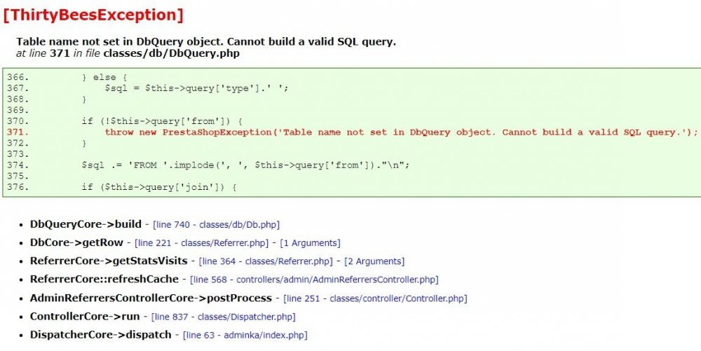

  14. That sounds quite likely. However, the Stats > Referrers page gives an error:
  15. Only visible when you move your mouse over it. That is why I missed it. Maybe such a design is not such a good idea... Actually it is important to be clear about the requirements of 1.3. I am migrating a shop and was planning to immediately upgrade it to 1.3. That failed for other reasons. BTW after the migration I get on some pages a duplicate key error in the ps_referrer_cache table. Any idea what that might be?
