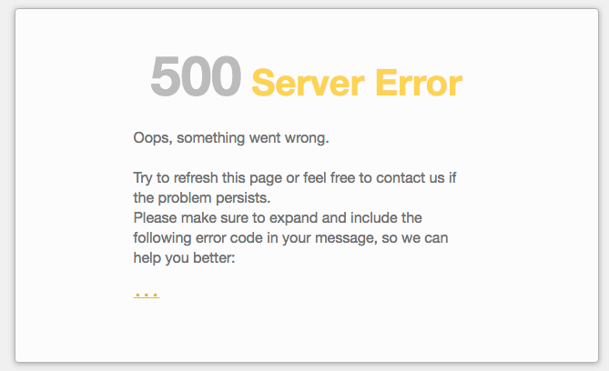

ok, I just finished following the article, the front end is working but I'm getting a 500 error logging in to the back office.
This is the error on nginx logs:
2018/02/07 10:01:29 [error] 2468#2468: *2921 FastCGI sent in stderr: "PHP message: PHP Fatal error: Class 'ModuleStats' not found in /home/domain/domains/new.domain.com/public_html/modules/statsmodule/statsmodule.php on line 551" while reading response header from upstream, client: 79.12.245.69, server: new.domain.com, request: "GET /admin3892b5trc/index.php?controller=AdminModules&token=29fb394ab861c81bbeb0c6d5ddfc9d63 HTTP/2.0", upstream: "fastcgi://127.0.0.1:8012", host: "new.domain.com", referrer: "https://new.domain.com/admin3892b5trc/index.php?controller=AdminDashboard&token=ac94432f16559f611a6f76f6ae98a0a6"
I double checked the statsmodule and I confirm that is uploaded in modules dir. Permissions seems ok.
Another error on error.log is: 2018/02/07 10:06:28 [error] 2468#2468: *2921 FastCGI sent in stderr: "PHP message: PHP Notice: Undefined index: lazy_load in /home/domain/domains/new.domain.com/public_html/vendor/smarty/smarty/libs/sysplugins/smarty_internal_templatebase.php(157) : eval()'d code on line 76
I'm on a Debian 8: php 5.6.x (phpfpm) nginx 1.10.x

I chmodded to 775 directory and files and I'm getting the same error.

Now I deleted and the error about is not logged anymore... but I still get a 500 error page on TB back office (without specific info about the error).

Now I'm getting: 2018/02/08 01:12:59 [error] 27709#27709: *11509 FastCGI sent in stderr: "PHP message: PHP Notice: Undefined index: lazy_load in /home/domain/domains/domain.com/public_html/vendor/smarty/smarty/libs/sysplugins/smarty_internal_templatebase.php(157) : eval()'d code on line 76 PHP message: PHP Notice: Trying to get property of non-object in /home/domain/domains/domain.com/public_html/vendor/smarty/smarty/libs/sysplugins/smarty_internal_templatebase.php(157) : eval()'d code on line 76 PHP message: PHP Notice: Undefined index: lazy_load in /home/domain/domains/domain.com/public_html/vendor/smarty/smarty/libs/sysplugins/smarty_internal_templatebase.php(157) : eval()'d code on line 76 But I think is related to browsing the front end.
Are you using the default theme? If not you can add this to the bottom of your themes config.xml, right before the last line, <lazy_load>1</lazy_load> <high_dpi>1</high_dpi> <webp>1</webp> as this error is happening in the backend, I find it hard to believe it will help, but you can try. I assume this issue needs to be addressed by a developer...
