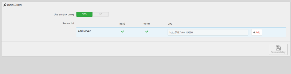

The CURL works in terminal - I get a confirmation that elasticsearch is running and ready to go.  I finally got the module to give me an error after hours of trying stuff:
Error!
Unable to connect with the Elasticsearch server. Has the connection been configured?
The weird part is, from the server side, everything appears to be fine!

I tried with or without https (just in case and for good measure!):
http://127.0.0.1:9200
https://127.0.0.1:9200
https://localhost:9200
http://localhost:9200
Regardless of the combinations, I get a connection error as if nothing has been configured at all!  I tried with or without Ajax proxy.  I really cannot tell what I am doing wrong!
Edited by movieseals
I truly appreciate everybody's help.  Just been trying to figure this out for over 9 hours...  I am able to connect with Redis and Memcache to the same localhost, granted through different ports, so that cannot be the issue.  I know the port for elastic search is open, the server says so.

I managed to reinstall the module and it seems to work, although it still refuses to connect.
The only version of elasticsearch I can manage to install on the server that actually connects properly on port 9200 is 6.8.0.  No other version will work: neither before or after (7.1.1).
I tried to delete the vendor folder, set a composer.json with 6.8.0, run composer update then composer install, and I get this error:
Your requirements could not be resolved to an installable set of packages.
  Problem 1
    - The requested package elasticsearch/elasticsearch 6.8.0 exists as elasticsearch/elasticsearch[0.4.x-dev, 1.0.x-dev, 2.0.x-dev, 5.0.x-dev,6.0.x-dev, 6.5.x-dev, 6.7.x-dev, 7.0.x-dev, dev-loekvangool-patch-1, dev-master, dev-sarwarbhuiyan-patch-1, dev-sarwarbhuiyan-patch-2, dev-sarwarbhuiyan-patch-2-1, dev-travis, v0.4.0, v0.4.1, v0.4.2, v0.4.3, v0.4.4, v0.4.5, v1.0, v1.0.1, v1.0.2, v1.1.0, v1.2.0, v1.2.1, v1.2.2, v1.3.0, v1.3.1, v1.3.2, v1.3.3, v1.3.4, v1.4.0, v1.4.1, v2.0.0, v2.0.0-beta1, v2.0.0-beta2, v2.0.0-beta3, v2.0.0-beta4, v2.0.0-beta5, v2.0.1, v2.0.2, v2.0.3, v2.1.0, v2.1.1, v2.1.2, v2.1.3, v2.1.4, v2.1.5, v2.2.0, v2.2.1, v2.2.2, v2.2.3, v2.3.0, v2.3.1, v2.3.2, v2.4.0, v5.0.0, v5.1.0, v5.1.1, v5.1.2, v5.1.3, v5.2.0, v5.3.0, v5.3.1, v5.3.2, v5.4.0, v6.0.0, v6.0.0-beta1, v6.0.1, v6.1.0, v6.5.0, v6.7.0, v6.7.1, v7.0.0, v7.0.1] but these arerejected by your constraint.
So clearly the 6.8 package is not there...
Like stated, I tried various other versions but they will not connect on port 9200 server side.
As for the elasticsearch module, it used to see the elasticsearch version, now all its states is: Elasticsearch version:Unknown
It still refused to connect to anything, regardless, claiming: Unable to connect with the Elasticsearch server. Has the connection been configured?
