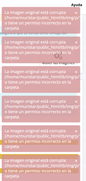

danwarrior Posted December 7, 2020 Posted December 7, 2020 On 11/8/2020 at 10:46 AM, Joint Systems said: I finally found the solution. If you use paint, IrfanView or other graphics program to change the jpg or JPG to a png file it miraculously shows up so long as you have .png files selected in preferences/images. This works only where some of the pictures weren't showing up not where none of the pictures in the featured products are showing up. The same pictures are being used in multiple TB shops work in some and not in others, and it does not matter if you are using the default theme or the community theme. The pictures show up in the home directory in all the shops whether they are .png of .jpg but only show up in featured or popular (depending if you are looking at the back office or popular on the public front side) in some of the stores though the image settings are the same. Another image problem is when you are adding images in some shops show up when you upload them in the process of choosing a main picture in others thy do not, either way once chosen they do show up in the folder. Thanks for sharing! I have the same problem and I don't understand wich the solution is, can you please specify? I was using Store Manager and after lots of tries, I've just imported the products from database (PS 1.6) to database (TB 1.1.0). I copied all the /img/p directory and when click to regenerate thumbnails, it only shows this message constantly. I can't understand why is using that route, /home/muristar/public_html...? (Muristar is the domain). The images are there, and permissions are not the problem... Any idea to help? Thanks so much!
