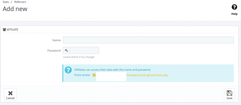

Mark Posted July 20, 2020 Posted July 20, 2020 (edited) In Stats/referrer/edit if I try to add an affiliate it says as per the attached image. Its a terminal error, can't continue without it being fixed, but in all likelihood an easy fix due to a column/table name Edited July 21, 2020 by Mark
