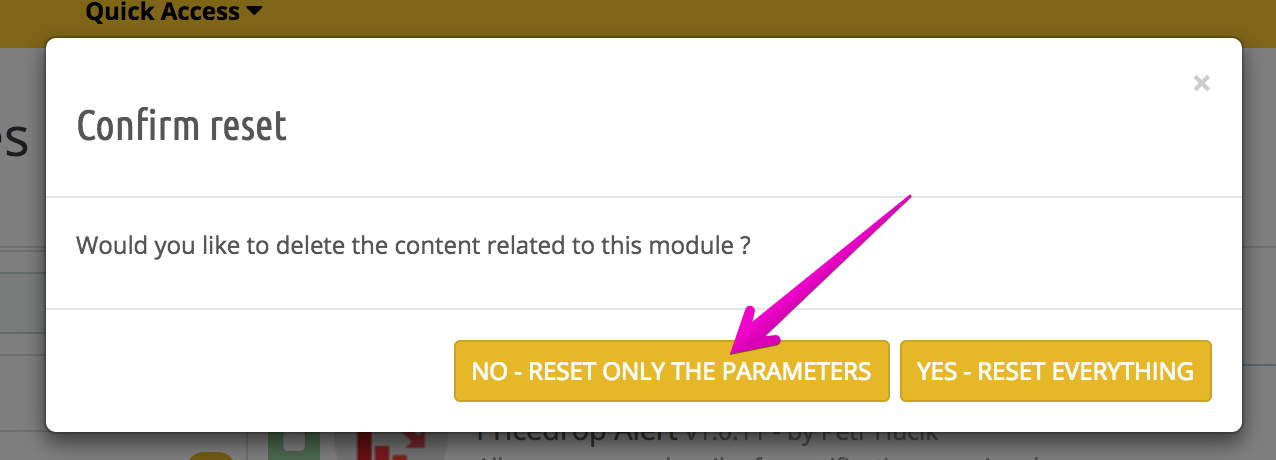

datakick Posted July 16, 2018 Posted July 16, 2018 @movieseals did you update from older version? If so, you'll need to reset the module (so the new hook get registered). Just make sure you reset only the parameters. If you reset everything, you'd loose price alerts data

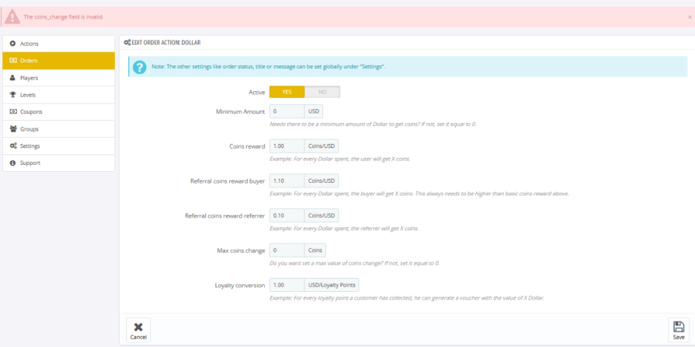

colorful-ant Posted August 24, 2018 Posted August 24, 2018 @wakabayashi Thank you. So far I had only tested the points with the individual add. It did not work for the coins either. Since you wrote that there are no problems with you, I have started another attempt. This I have done in a test shop with only one language and it worked perfectly. It seems like it does not work for me with multiple languages in the shop to individually add points or coins.
wakabayashi Posted August 24, 2018 Author Posted August 24, 2018 Hm strange. Have you filled in all languages title and description?
colorful-ant Posted August 24, 2018 Posted August 24, 2018 @wakabayashi yes i have - clear cache etc - shop with multiple language wont work on my tests, single language no problem with individual points and or coints i dont know if i have another problem with this - i will continue to test it
wakabayashi Posted August 24, 2018 Author Posted August 24, 2018 Have you debug mode on? doesn't it say anything?
wakabayashi Posted August 24, 2018 Author Posted August 24, 2018 But I am bit confused. you try to give points, but actually you are working with coins aren't you?

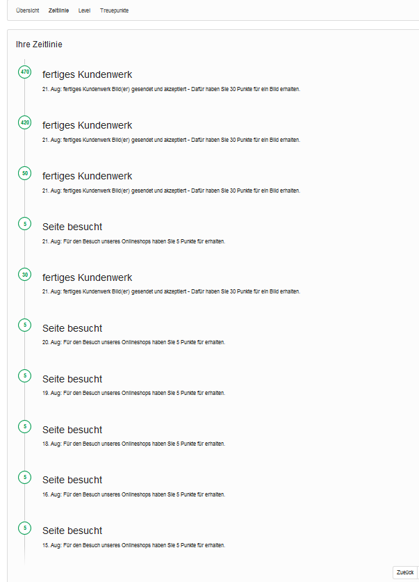

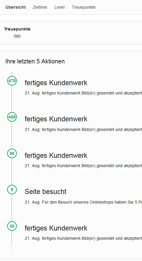

colorful-ant Posted August 24, 2018 Posted August 24, 2018 first days only with points tried. the "individual" points themselves are shown in the list, only the total number of points has not changed. I tried that with the coins and did not work. in another test shop with only one language the points of the total number are added only not in the shop with several languages better german now ersten tage nur mit punkten versucht. die "individuellen" punkte an sich werden in der liste gezeigt, nur die gesamtanzahl der punkte hat sich nicht verändert. das habe ich nun auch mit den coins probiert und auch nicht funktioniert. in einem anderen testshop mit nur einer sprache werden die punkte der gesamtanzahl addiert nur nicht beim shop mit mehreren sprachen
wakabayashi Posted August 24, 2018 Author Posted August 24, 2018 Ich habe es jetzt gerade noch einmal mit multilang probiert, hat auch funktioniert. Wie sieht denn der Kunde im Backoffice aus?
colorful-ant Posted August 24, 2018 Posted August 24, 2018 mit nur einer sprache wird die gesamtanzahl der points und coins korrekt angezeigt - im multilangshop nicht muß ich wohl nochmal alle einstellungen durchsehen, wenn es bei dir funktioniert bisher ja nur test noch nicht live - somit habe ich keine panik damit ;)

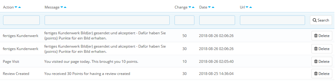

colorful-ant Posted August 26, 2018 Posted August 26, 2018 suggestion Admin area Player list/history Course of the points and coins of a player modules / genzo_krona / controllers / admin / AdminGenzoKronaPlayersController.php ``` $idcustomer = Tools::getValue('idcustomer'); $fields_list = array( 'id_history' => array( 'title' => 'ID', 'align' => 'center', 'class' => 'fixed-width-xs', 'alias' => 'h', 'filter_type' => 'int', ), 'title' => array( 'title' => $this->l('Action'), 'align' => 'left', ), 'message' => array( 'title' => $this->l('Message'), 'align' => 'left', ), 'change' => array( 'title' => $this->l('Change'), 'align' => 'center', 'class' => 'fixed-width-xs', 'filter_type' => 'int' ), 'url' => array( 'title' => 'Url', 'align' => 'left', 'remove_onclick' => true, ), ); ``` to ``` $idcustomer = Tools::getValue('idcustomer'); $fields_list = array( 'id_history' => array( 'title' => 'ID', 'align' => 'center', 'class' => 'fixed-width-xs', 'alias' => 'h', 'filter_type' => 'int', ), 'title' => array( 'title' => $this->l('Action'), 'align' => 'left', ), 'message' => array( 'title' => $this->l('Message'), 'align' => 'left', ), 'change' => array( 'title' => $this->l('Change'), 'align' => 'center', 'class' => 'fixed-width-xs', 'filter_type' => 'int' ), 'date_add' => array( 'title' => 'Date', 'align' => 'left', ), 'url' => array( 'title' => 'Url', 'align' => 'left', 'remove_onclick' => true, ), ); ``` i add this before 'url' => array( 'date_add' => array( 'title' => 'Date', 'align' => 'left', ),
colorful-ant Posted August 26, 2018 Posted August 26, 2018 better for translation add this 'date_add' => array( 'title' => => $this->l('Date'), 'align' => 'left', ),

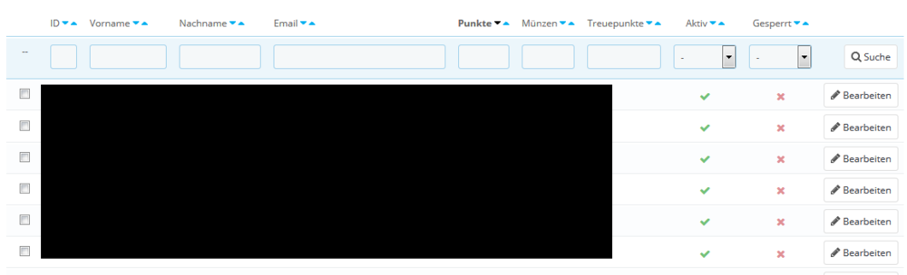

colorful-ant Posted February 22, 2019 Posted February 22, 2019 (edited) i changed the module a little bit for me - now i can search with customer-email at the backoffice module - genzo krona - players list modules / genzo_krona / controllers / admin / AdminGenzoKronaPlayersController.php my changes $this->_select = 'c.`firstname`, c.`lastname`'; to $this->_select = 'c.`firstname`, c.`lastname`, c.`email` '; this (public function __construct..... ) $fields_list['lastname'] = array( 'title' => $this->l('Lastname'), 'align' => 'left', 'filter_type' => 'string', 'filter_key' => 'c!lastname' ); $fields_list['pseudonym'] = array( 'title' => $this->l('Pseudonym'), 'align' => 'left', ); to $fields_list['lastname'] = array( 'title' => $this->l('Lastname'), 'align' => 'left', 'filter_type' => 'string', 'filter_key' => 'c!lastname' ); $fields_list['email'] = array( 'title' => $this->l('Email'), 'align' => 'left', 'filter_type' => 'string', 'filter_key' => 'c!email' ); $fields_list['pseudonym'] = array( 'title' => $this->l('Pseudonym'), 'align' => 'left', ); and this (public function renderList) $fields_list['lastname'] = array( 'title' => $this->l('Lastname'), 'align' => 'left', 'filter_type' => 'string', 'filter_key' => 'c!lastname' ); if ($this->is_gamification && Configuration::get('krona_pseudonym', null, $this->id_shop_group, $this->id_shop)) { $fields_list['pseudonym'] = array( 'title' => $this->l('Pseudonym'), 'align' => 'left', ); } to $fields_list['lastname'] = array( 'title' => $this->l('Lastname'), 'align' => 'left', 'filter_type' => 'string', 'filter_key' => 'c!lastname' ); $fields_list['email'] = array( 'title' => $this->l('Email'), 'align' => 'left', 'filter_type' => 'string', 'filter_key' => 'c!email' ); if ($this->is_gamification && Configuration::get('krona_pseudonym', null, $this->id_shop_group, $this->id_shop)) { $fields_list['pseudonym'] = array( 'title' => $this->l('Pseudonym'), 'align' => 'left', ); } my image result and complete .php-file AdminGenzoKronaPlayersController.php Edited February 22, 2019 by colorful-ant 2
