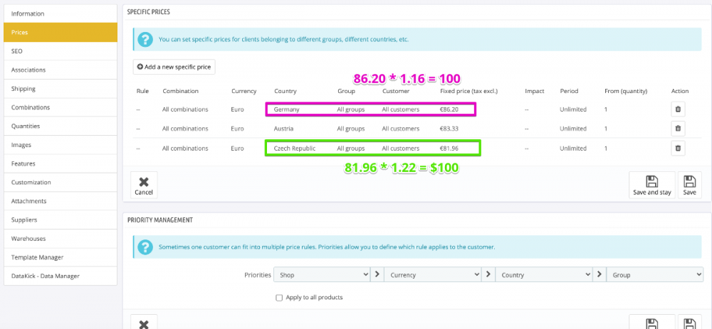

The only way to have the same final price (for virtual products) is to create Specific Prices - you will need to enter different base price for every country in the EU.
Something like this (if you wanted to have $100 final price):
Theres's no way to change semantics of the stored price. There are thousands of lines of code that *expect* this to be Price without TAX. Also, every module that exists expects the same semantics. This will never change, no matter how many times you ask.
If you really need this, then figure out how to import specific prices. Because maintain this manually would be... bold.
