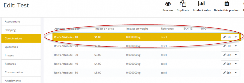

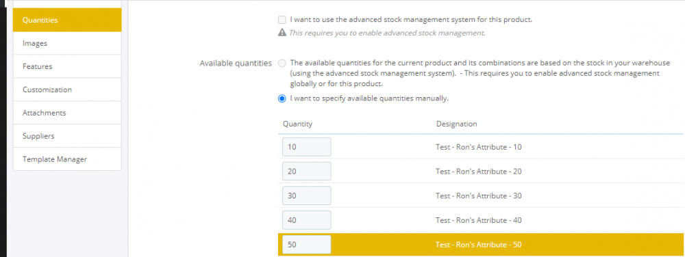

I set up a new product AND new attributes and the affect is real. I don;t think it is reading in reverse but I did notice that everything works fine until you change one of the stock quantities to zero. At that moment I think the default combination gets corropted
See here, I have set the default combinations to "10"
As soon as you change a quantity to zero the defaul combination on the quantity tab changes, but stays the same on the combinations tab
So it looks like the combinations tab thinks the default is different to the quantity tab. Then there is no way back, it just gets worse with every change. Weird
Good luck, hope someone can help further

Ok. So I adjusted the quantities/stock of another product that had a few more combinations using Store Manager and it worked again so Store Manager is entering my stock correctly and making it show up in the store correctly but it still shows up in the store back office as mixed up.
I attached pics of this other product which has 4 combinations. 100K W value is actually 16!
So I just have to figure out why things are off when combinations are generated in the back office. Oooooh! I'm going to try and create a new product with combinations in Store Manager to see what happens!
